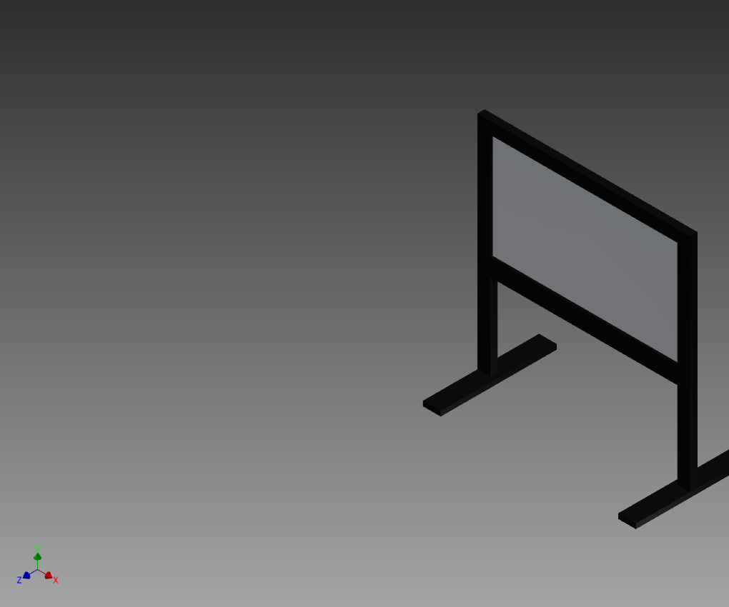

Step 1: Initial Design
The first step was to design the tool holder in Inventor. Each piece will be cut from 1/4 inch piece of wood with a laser cutter. For this we need to design each piece as a separate Inventor part.
Step 2: Assemble the Pieces
After the pieces are modeled they need to be assembled to help define where to cut the notches. The image provided shows how each piece is overlapped during the assembly.
