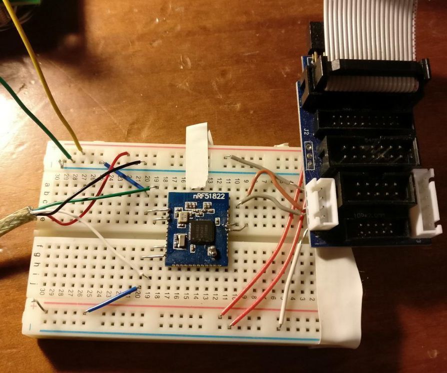

Introduction: Using Cordova to Create Bluetooth Mobile App (for Temperature Sensor)
In my previous Instructables
https://www.instructables.com/id/Bluetooth-Temperature-Sensor-for-SmartPhone/I've showed how to connect a temperature sensor MCP9808 to Bluetooth nRF51822 device to transmit temperature measurements to your cellphone
Now that you have a working Bluetooth temperature sensor connected to your cellphone you may want to display temperature measurements in a nice way that just using nRFconnect utility from Nordic Semi.
Please note the current application is for demonstration only and should not be used in Production systems
Picture above shows the final application running on my Android phone
