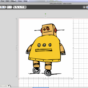

The first step for this project is to import the picture you want into the Silhouette program. I chose the Instructables robot.

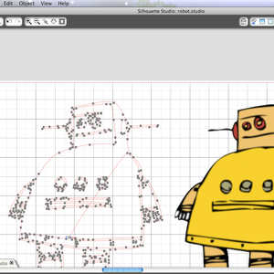

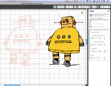

- Click the House icon along the top of the page.
- Along the right you will have the option to Trace, click that.
- Now select Select Trace Area and highlight your image.
- Click the Trace option because you want all of the lines.
- Once it is traced, drag away your image and you will be left with your traced/cut lines.

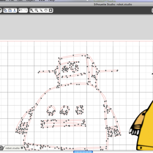

- You are going to have more lines than you want so you need to delete some keeping in mind what you are going to peel off later.
- Click the second arrow down on the right, Edit Points.
- Select the points you don't want and click the Delete Point option on the right. If you just click the delete key, you will delete all of your lines. You need to delete points. But this is easy because you will probably delete whole sections or shapes.
- Make sure you have a defined outline of the shape.
- If you need more detail (like I had to add in a neck line), just use the Draw a Polygon or Draw a Curved Shape option and add in what you need.

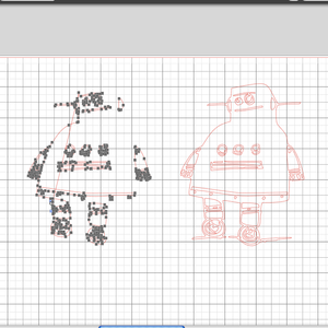

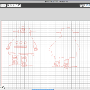

- Once you have the image the way you want it, copy and paste it so you have two side by site.
- You want to delete the outline on one and the inside on the other. Use the delete points option.
- After deleting the outside and the details, make sure you don't resize either unless you resize them together, otherwise it won't match up right.
