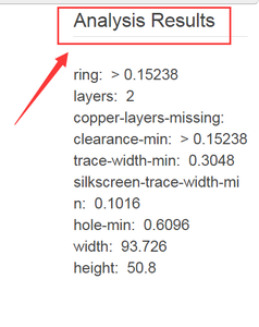

Step 9: Easy to Find Your PCB Parameters for PCB Order
EasyEDA provides a simple but adequate DFM check, the Analysis Results its a great tool.You can see all the details of PCB parameters before ordering, such as the board size, hole and track sizes and clearances of the various PCB objects such as tracks and pads.
