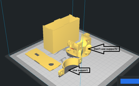

Firstly, 3D print "Control Box - A.stl" and "Control Box - B.stl"
You can find the files in this thing: https://www.thingiverse.com/thing:4793758/files

Since the motor will rotate at high speeds and will engrave/drill, it must be quite rigid in order to get a proper result. I tried 4-5 different models to make this motor carrier and this was the most satisfied one. It is very rigid as it is directly attached to the screws to which the bearings are attached. I know it is a bit long to set up, but this is necessary for a rigid system.I plan to make a quick-change system in the future, but this carrier is enough for now.
First, 3D print the "Ender 3 Drill Carriage - A.stl" file. Use at least 60% infill, no need to use support. Than 3d print the "Ender 3 Drill Carriage - B.stl" file. Use supports.
