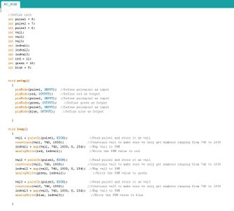

Step 3: The Code
Now i started coding,
I used the pulseIn() function to read the pulses from the receiver and send them to the serial monitor, when i had those values i told the arduino to map those to the PWM values (0-255) and send them to the serial monitor again.
Now when i moved the joystick on the remote i saw the values change.
Now the last part of the code sends those PWM values to the led and fades it accordingly.
I was happy when i got this working but i needed a bit more challenge, i wanted it to control an RGB LED.

Step 5: RGB Code
Now I just altered the code a bit to add two more led's and two more inputs.
I also removed the serial commands because i didn't need to debug it anymore.
Then i uploaded it and it worked fine :)
