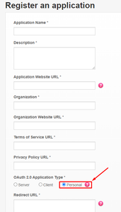

First we have to be able to actually pull data from the Fitbit, so we need to bring over some freshly baked cookies and kickoff our communication. Start by going to https://dev.fitbit.com/apps/new to register a new app.
You'll want to login as the account associated with the Fitbit. This saves a LOT of hassle.
The main field to note is Oauth 2.0 Application type, which should be set to Personal. For your Redirect URL, you can just use http://localhost . All the names and URLs can be filled in with anything, since it's a personal app and you don't exactly need to write a Privacy Policy for yourself.

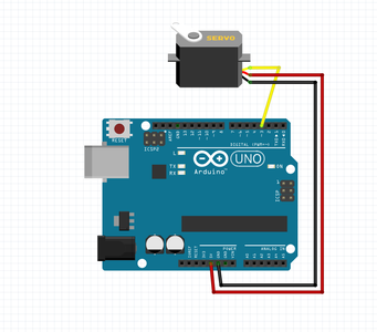

Controlling lights and playing sounds is a solid start, but I wanted things to physically happen in the room. Cue Arduino.
I thought "what would be a scary thing to have happen in the room" and the conclusion I came to was that something randomly falling would do the trick. My setup was a bit comical, but if it works it works, right? I used a toilet paper roll around a servo that can rotate 360 degrees and attached a string to it. I ran the string to a stand of mine and set it slightly off balance to make it easier to trigger. This way, the servo pulled the string around the toilet paper roll and caused the stand to fall.
Since I only had 1 Arduino interaction setup, I went ahead and just triggered it as soon as there was something sent over serial. However, it'd be very easy to run different functions based on the serial message.
I also included a failsafe where the Arduino event would trigger after a set amount of time if it hadn't happened already, because not having things fall during a scary movie sounds tragic.
