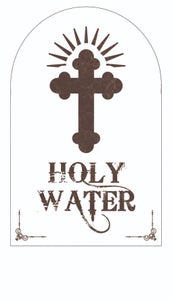

Step 1: The Label on the Bottle
Cut out the label you want to glue on the bottle. You can print one you found on the internet or, if you have the skills, design one yourself. You can also download the label I designed from the pictures above. I printed the label on brown colored paper so it is easier to make it appear old.
Coat the back of the label completely with glue and press it on the bottle. Don't worry if it isn't on the right spot at once. You can slide the label a bit till you like it. If the glue becomes visible doing the sliding that is perfectly fine because we are going to ad a lot more glue later.
