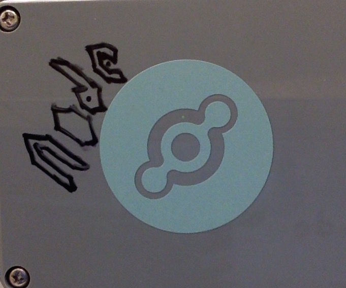

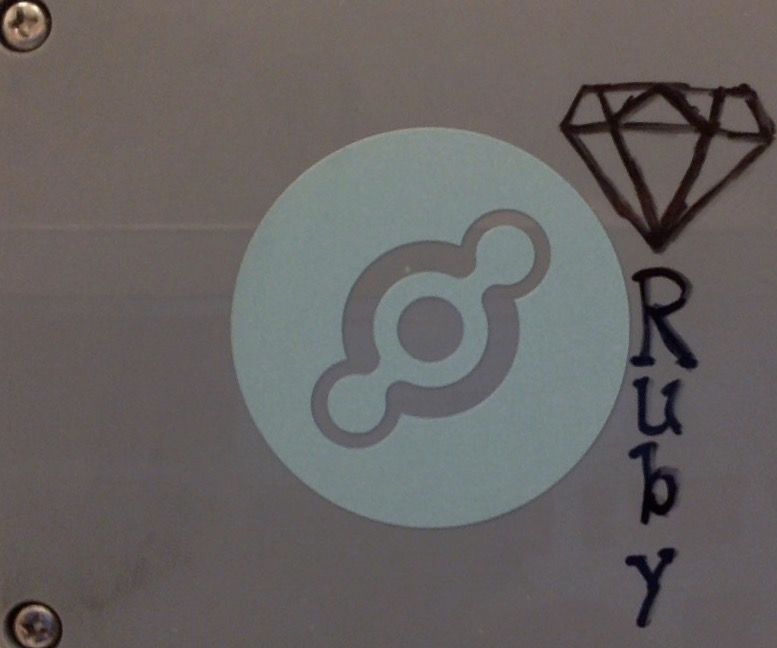

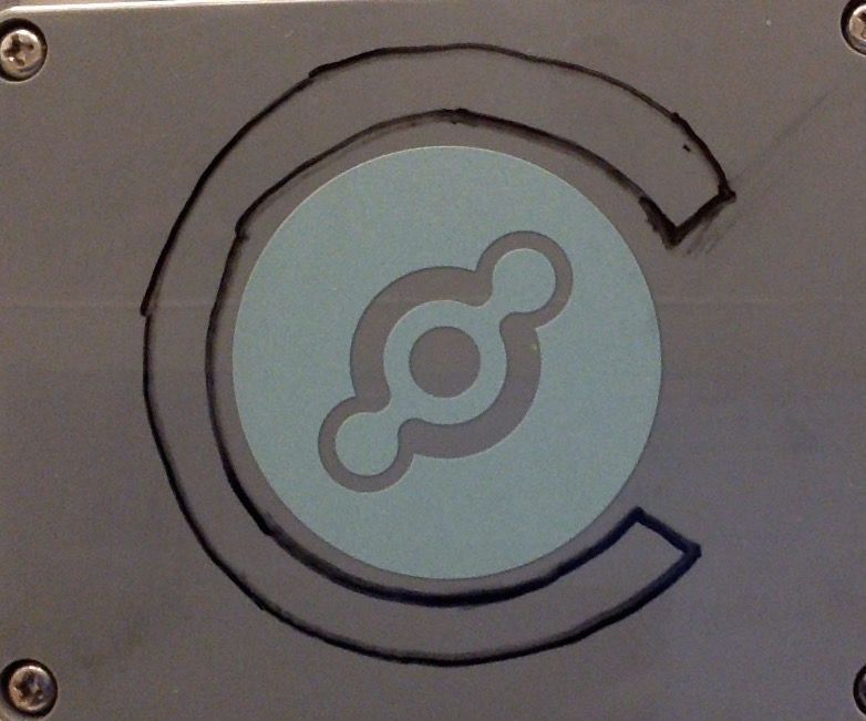

Helium is a complete wireless platform for the internet of things, supplying integrated hardware, software interfacing, and infrastructure to easily, efficiently and securely connect objects to the internet. If you don't have hardware you can still interact with the Helium Network subscribing to our virtual Atoms, leveraging one of our SDKs (Ruby, Node, C). This tutorial builds on the SDK subscription walkthroughs, showing you how to use them to interact with the virtual Atoms. All MAC addresses and corresponding Tokens are functional, so feel free to use them yourself!
