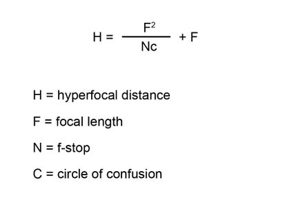

Step 1: Calculating Hyperfocal Distance
Some lenses come with a depth of field scale in them already, but for those that don't, the hyperfocal distance equation would come into play. The hyperfocal distance equation involves the focal length, f-stop and circle of confusion.
*The circle of confusion is just that: confusing. There is much debate over the "proper" circle of confusion among different cameras and lenses, listed on www.dofmaster.com, including a circle of confusion calculator, which you can view by clicking the link below.
http://www.dofmaster.com/digital_coc.html#coccalculator
Once the hyperfocal distance is calculated, the depth of field will extend from half the hyperfocal distance to infinity, making the whole image focused, producing a great depth of field.
The second image is a more visual example of the equation, and much easier to understand.
