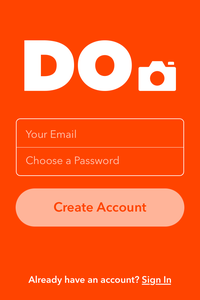

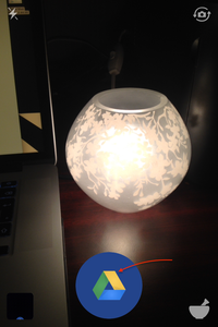

Step 1: Download IFTTT DO Camera on Your Device
The first thing you will need is the DO Camera app: https://ifttt.com/products/do/camera
Download it on to your device and sign in to the app with your IFTT account.

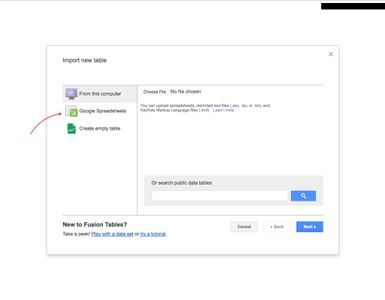

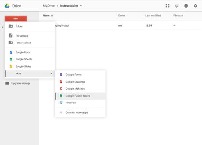

Step 3: Create a Google Fusion Table
1) Go back to your drive (https://drive.google.com/). Click on the red button that says New, go to "More", and click "Google Fusion Tables".
2) A screen will appear that is titled "Import New Table"
3) Click on "Google Spreadsheets";
4) Click on the spreadsheet that you have just created, and click "Select". You may be asked to authorize Google Fusion's Synchronizing feature. If you are prompted, click "Allow" and select the spreadsheet you have created, and click "Select" You will be brought to a new screen. There is a box next to some text that says "Column names are in row". Make sure that the titles of your columns we just created are selected in the row. If not, select the row with the titles of your columns. Click "Next >>" and then "Finish"
Note: If you haven't created a Google Fusion Table Before, I recommend following my previous Instructables, Create a Clickable Google Map to Share Geographic Information and Metadata

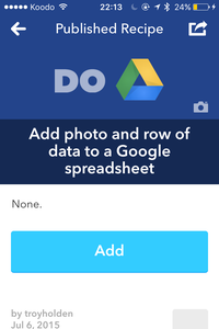

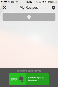

Step 4: Connect IFTTT DO Camera and Google Drive (Part 1)

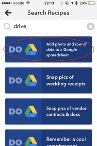

1) Open the DO Camera App, and create a new recipe
2) Click the search button in the top right-hand corner
3) Search "drive" and select "Add photo and row of data to a Google spreadsheet". (You may need to scroll through recipes).
4) Click "Add"

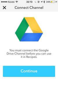

Step 5: Connect IFTTT DO Camera and Google Drive (Part 2)

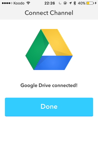

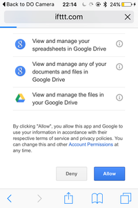

5) You will need to connect your Google Drive to the app. If the DO Camera prompts you to connect the app to Google Drive, click Continue.
6) You will be directed to a page in your device's browser to authorize DO Camera to access your Google Account (You may need to sign in). Click "Allow"
7) Once Google Drive is Connected, hit "Done"

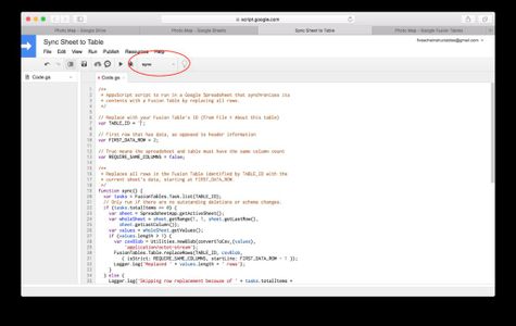

1) Open the Google Sheet you are working on and click "Tools" > "Script Editor"
2) Paste the script from the documentation above into the body of the code and click "File" > "Save". Name the script something memorable

5) Return to the script we were working on earlier. Where you see 'YOUR TABLE ID', paste the ID number of your fusion table between the two apostrophes: ' '
6) change the value circled in the image above to false
7) Go to "Resources" > "Advanced Google services..."
8) Scroll down to Fusion Tables API and click "On"; Click "Ok"
9) Hit the "sync" button. (If the script requires authorization click The app will need to be authorized. Click "Continue"; Click "Allow") Your script will fail, but that's okay! Click on details.
