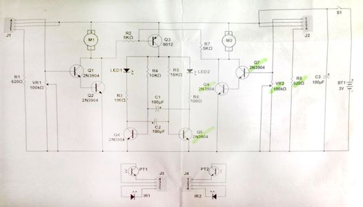

Step 1: Making a Sensor
First of all we have to make a sensor.

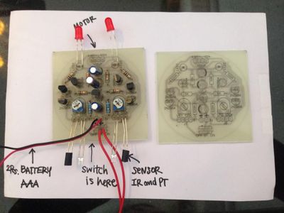

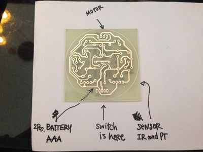

This sensor circuit has designed to combine 2 electric circuit of the IR sensors into 1 board. It means that you can use this to make a simple moving toy or use 2 set of IR sensor in with this circuit board as the pictures show there are two side of sensor and motors. So technically, you can put electric appliances only one side of the board to use only a set of sensor and a moter. ( **Note thet the motor will be at the opposite side of its circuit. Foe example, M1 which located in the top left of the board will use all the electric appliances on the right side of the board so M2 will use others in the left side)
***For the picture #2, there are an example of the circuit but you don't have to weld the sensor like that because we will have to attach them into the fan's face cover. Only do that if you would like to test the circuit and the switch of the fan.
Right here, I have already upload photos of the circuit so you can copy it and make one.

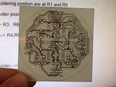

What you need:
-2 resistors 620 ohm (Blue Red Brown Gold) --> soldering postion are at R1 and R8
-2 resistors 5k ohm ( Green Black Red Gold) --> sodler position are at R2 and R7
-2 resistors 100 ohm (Brown Black Brown Gold) --> R3 , R6
-2 resistors 10k ohm ( Brown Black Orange Gold) --> R4,R5
-6 Transistors 2N3904 NPN
-1 Transistor 9012 PNP
- 2 Adjustable resistors 100k ohm (104 blue and white) --> VR1,VR2
- 3 capacitors 100 uF 16v
- 2 red LEDs 5 ml.
- soldering iron
- wires
- solder
To test the sensor :
- Don't turn the sensor (IR and PT) face the light directly because the light will make the IR send the signal to the PT
- If using an object for the sensor to detect, use an object with bright color. Do not use object with black or dark color.
- Turn the Adjustable Resistor counterclockwise to its limit then start to testing the sensor (Weaving a hand or something in front of the sensor) if the LED is not turn on or the motor still doesn't work then turn the Adjustable Resistor clockwise a little more (a very very little more) untill it works out. ** You can adjust the sensitivity of the sensor at this point, by turning this resistor till you like it. *** REMEMBER to only turn the resistor a little more each time. If you have turn it too much or lose the level of it, you can start it over by turn the power off and trun the resistor to counterclockwise to its limit then turn on again but you may have to wait for it to reset their value to or you may have to turn off and on for 2-3 times.
If the sensor doesn't work:
- Check the battery. It works well with Alkaline battery. If you use rechargeable battery, it may not work properly due to the lower volt and mA of this battery kind. (Alkaline is 1.5v but, rechargeable battery is 1.2v)
- Check the wire and the print-wiring board if every lines are all right connected
- Check the electronic appliances, if they are all place at the right positions.
