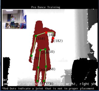

Step 2: Choosing Joints to Analyze
The majority of this coding happens in the skeleton stream renderer.
Since we were making this project specifically for dance, We knew we only wanted to look at certain joints.
First, make a list that will contain the joints we do not wish to see where we introduce other variables:
private list NoJoints;
Second, we must initialize the list in the public override void initialize section of coding
NoJoints = new List {JointType.Spine, JointType.ShoulderCenter, JointType.Head, JointType.HandLeft, JointType.HandRight, JointType.HipCenter, JointType.FootRight, JointType.FootLeft, JointType.ElbowLeft, JointType.ElbowRight };
Third, we must tell the program to not draw the joints contained within the list. Go down the code to the place where the joints are drawn. There should be a green comment that says "Now draw the joints":
if (!NoJoints.Contains(j.JointType))
this.SharedSpriteBatch.Draw(
this.jointTexture,
this.mapMethod(j.position),
null,
jointColor,
0.0f,
this.jointOrigin,
1.0f,
SpriteEffects.None,
(0.0f) ;
The code in the curly brackets is already there when the file is opened. We are simply telling it that if the list does not contain a joint in the list NoJoints, then the program should draw it.
You can also add and remove bones to connect the joints. This is as simple as commenting out the bones you don't want and following the code written for the bones to draw in new ones. The guide is:
this. DrawBone (skeleton.Joints, JointType.Joint1, JointType.Joint2);
Step 3: Step 2: Finding Joint Coordinates for Comparison
The main purpose of this program is to compare certain sets of joints and deciding if they are in optimal position. to do this we have to be able to track the position of the joints on the screen. to do this, we use mapMethod(j.Position).
first, we have to load the font that we will use for several functions throughout the program. scroll down till you see protected override void LoadContent (). In the brackets write this code:
this.font = Game.Content.Load<SpriteFont>("Segoe16");
Right underneath where we wrote the if statement for drawing certain joints, we will tell the program to track the joints on screen:
this.SharedSpriteBatch.DrawString(font, "(" + mapMethod(j.Position).Y + ")", mapMethod(j.Position), Color.Black);
the sprite batch function draws text on the screen and the mapMethod(j.Position) finds the joint position.
I only chose to write the Y coordinate on the screen because the X coordinate stays constant.

Step 5: Step 3 Continued:
We then have to relay the signals to the screen and give the program scenarios of joint levelness:
underneath the variables we added, we must tell it what to write in certain situations. We called them danceMessage and danceMessage2. Here we will also give the program our current skeleton that we want it to check:
             int currentSkeleton = 0;
            string danceMessage = "Lower your:";
            string danceMessage2 = "Raise your:";
We will use these dance messagesto give the player corrections as he/she dances:
this code will go underneath where the coordinates for the joints are printed
this.SharedSpriteBatch.DrawString(font, danceMessage, new, vector2(0,450), Color.Red);
this.SharedSpriteBatch.DrawString(font, danceMessage2, new, vector2(0,425), Color.Red);
This code will go in the section "now draw the joints" to check each set of joints:
if (shoulderCheck[currentSkeleton] != JointType.Head)
                                switch (shoulderCheck[currentSkeleton])
                                    case JointType.ShoulderLeft:
                                        danceMessage += "left shoulder, ";
                                        break;
                                    case JointType.ShoulderRight:
                                        danceMessage += "right shoulder, ";
                                        break;
                                if (j.JointType == shoulderCheck[currentSkeleton])
                                    jointColor = Color.Red;
This is for the shoulder joints and it tells that if one joint is higher, it will be colored red, indicating that it is out of alignment. Once it placed level again, it will become green. Now write the code for the hip and wrist joints as well!!
