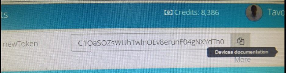

Variable ID and the authentication token are provided by Ubidots, as shown in Figure 2 and Figure 3. Variable ID is a unique alphanumeric string provided by Ubidots.The authentication token is also provided by Ubidots, in “API Credentials”

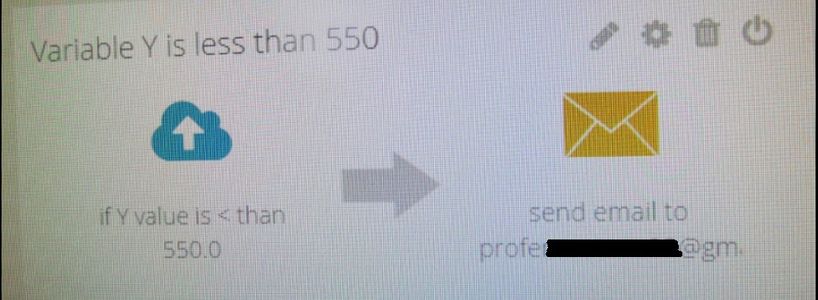

After uploading the acquired data to the Ubidots platform a set of services and additional options become available for the users. One of this options is the automatic generation of alarm notifications and messages triggered by conditions established by the user for the monitored variables.
We can configure an automatic SMS message to be automatically sent from Ubidots to a mobile phone when a variable goes down a pre-established value. The text messages are received in mobile phones from Ubidots after an event has occurred.
Additionnally we can configure automatic e-mail sending for a variable value threshold and e-mails will be received from the Ubidots platform as events occur.
