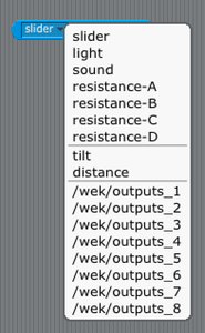

Step 14: Check to See If the Data Is Available in Scratch
In your Scratch 1.4 application, you should be able to see the output data options in the Sensor Value block dropdown list.
If you don't see the values, try quitting all the applications and starting again from Step 9 in this Instructable.

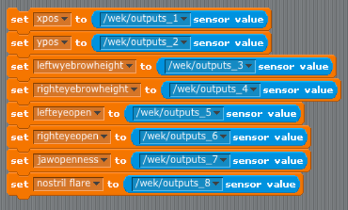

Step 15: Create Variables in Scratch for Each of Your Data Points
This is optional but very helpful.
Create a new variable for each data point and set them equal to the corresponding data from Wekinator. See image for an example.
You will have to put that whole block into a Forever loop so that the values continually update.

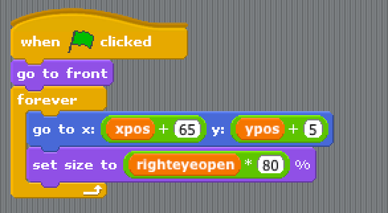

Step 18: Make Your Eye Sprites
Do the same with each eye. Add a set size for scaling to make the eyes smaller and bigger. I found that my eyes were getting a bit big, so I scaled down the size by 80%.
I created the left eye and scripts and then duplicated that sprite, reflected the costume, and adjusted the offsets for the right eye.

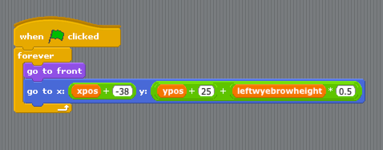

Step 19: Repeat This Process for the Eyebrow Sprites
I found that my eyebrows were going too hight so I scaled down the value by .5.

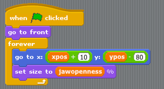

Step 20: Finish With the Mouth Sprite
