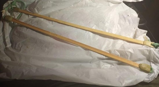

Step 5: Making Bars to Support the Legs

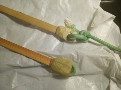

I thought it might be easier to just use some bamboo pieces across the back, so I made ends to attach them to the legs. At first, I made a loop just from the MS, but then I thought it might be more flexible from some extra paracord pieces and that seemed to work well. You can see I did try to sand the cured MS, and it did seem to sand well, but for this, it just needs to be functional, and I should be able to fold it for storage. I need to modify the legs because they slid out of the paracord ties
Step 6: More Stable
After tying the paracord on my main project, I knew I needed to modify the main supports.
I untied them, and added some additional MS. made the backs a few inches taller, added a back piece, and less of a lip. This really has been a fun learning experience and I should have initially tried some cardboard pieces to begin just to test what may have worked.
After adding the new changes, allowed the additional area to cure, and tied them again. It works, but I'm adding footers to the pieces to make them more stable when the charger isn't present. They tend to flop over too much, and small footer pieces should help with that.

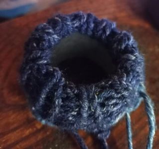

Here's just a little tube form knitted from Lion's Brand Jean yarn. I did a knit 1 purl 1 tube and will try to add some MS to part of the interior. You should be able to see from the photo how stretchy this particular knit is. I'd guess it can flex to be twice as wide when stretched as it is when resting.
For the purposes for this, I didn't really finish the knitting other than just casting off.

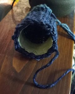

I mixed the MS, and made a small slab and put it around the small spray bottle and pressed the knitting into it. I left it on the bottle to cure.
The knit is well attached to the MS, but the MS doesn't really show too much from the fabric side. I think if I try to pull it away, it would probably rip the knitting. I will have to investigate this for pvc joints, and folding the knit over really looks fun.
The second to the last photo shows how the tube appears after the MS cured for several hours. The MS is very thin, but more could be added easily if needed. Since this was just a theory and a test, I am now thinking of several applications for this method.
