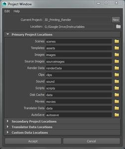

First off, let's do a bit a of housekeeping so we can keep stuff organized. We'll create a project directory so we have a place to store all our files cleanly.
Let's start off by creating a new project
File -> Project Window
In the example screenshot, I created a new project folder called 3D_Printing_Render which will be stored in my /Google Drive/Instructables/ path. Feel free to put yours wherever you'd like. Whatever you set as your current project will be the new folder created that will contain all the folders listed below that. When Maya generates files for your project, such as renders, temp render storage, or the scenes files themselves, it will put them in the folders defined in your project window. Wooo, clean workspace! \o/

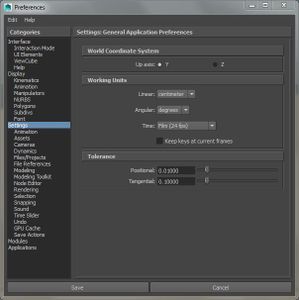

Let's make sure we are using Maya's default Working Units of centimeters (cm).
Windows -> Settings/Preferences -> Preferences -> Settings category
Check to see that the Working Units - Linear is set to centimeter.

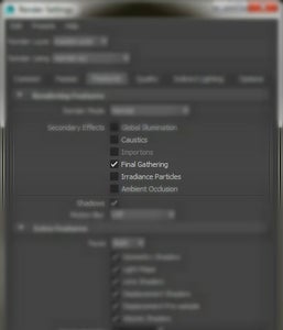

Enable Final Gathering
Render Settings -> Features -> Check Final Gathering
The settings to FG (Final Gathering) are in the Indirect Lighting tab under your Render Settings, but for now, we'll use all the defaults to get our shot. Final Gathering will take the IBL's color information, firing rays from

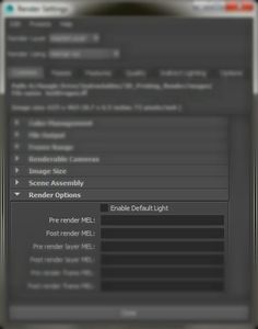

By default, Maya enables a directional light that will light the scene. Let's get rid of default lighting as our IBL node and FG will be doing the job of lighting our scene.
Render Settings -> Common -> Render Options -> Uncheck Enable Default Lighting
If you render, you should get a pretty decent looking image, but there's one more step we need to do before we can make pretty things :3

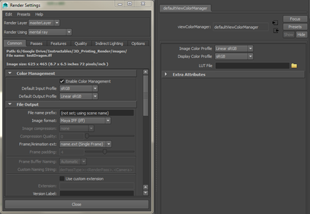

Step 8: Color Management - a Linear Mind Can Be Beautiful!
Most imaging professionals have adopted a linear workflow. To help achieve this, Autodesk introduced native support of Color Management in Maya 2011. To keep this tutorial quick, you can learn more about the importance of a Linear Workflow and Color Management in a great article written by Leif Pedersen.
To get the best looking render, we'll need to enable Color Management and set your view color profiles.
Render Settings -> Common tab -> Color Management category -> Check Enable Color Management
  • Set Default Input Profile to sRGB
  • Set Default Output Profile to Linear sRGB
Open your Render View window and go to Display -> click Color Management... and look at your attribute editor on the right where the "defaultViewColorManager" node's attributes are displayed
  • Set Image Color Profile to Linear sRGB
  • Set Display Color Profile to sRGB

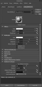

To get that slightly reflective look, we are going to apply a mia_material_x shader to the stage.
Select the stage "pPlane1", right click and hold, and select Apply New Material
Under the mental ray Materials category, select mia_material_x
mia_material_x is a powerful shader made for mental ray which allows us to do a whole lot more than what the basic shaders in Maya are capable of. If you render now, you'll see we're getting a whole new look for our stage, complete with a soft reflection of our dragon. We are getting a lot closer to a final product. To match my render's stage, let's change a few things in the attribute editor with this material selected.
Under Diffuse, set the Color to white
Under Reflection,set both the Reflection and Glossiness to 0.500 and the Glossy Samples to 32
Under Ambient Occlusion, Check Use Ambient Occlusion and set Samples to 32
Hit Render the current frame and let's see what we have! Since we changed our scene scale to a realistic size, we really don't have to tweak much of anything for the lighting to work. Feel free, however, to play around with settings, re-render, and see what changes. Generally if you up the samples on anything, you'll get a higher quality at the cost of render time. For a simple shot like this, you'll reach a point of diminishing returns if you set the samples too much higher.

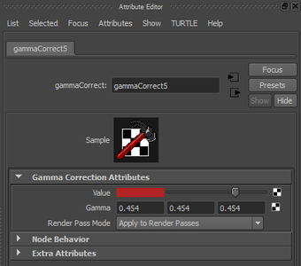

Let's change the color, too. Rather than change the color here directly, we need to gamma correct it before we pass it through to the shader's diffuse color value. Click the checkerboard icon next to Color under Diffuse in the attribute editor, go under the Maya category in Utilities and select the Gamma Correct node
With the "gammaCorrect1" node selected, change your value to the color you'd like. In my case, I made it a strong saturated red. To do so, bring up the color picker for the "gammaCorrect1" node's Value by clicking on the color box.
Set the HSV values to {0.0, 0.8, 0.7}
We included this node in our shader, rather than just directly setting the color, since we are now working in a linear workflow. To account for this, we need to correct our color values by multiplying the gamma by the reciprocal of 2.2, or (1.0 / 2.2) which is .4545... repeating.
Change each value in the Gamma box to 0.454.
*If your own model has an sRGB texture map available for it, you can connect a 2D Texture File node to the Gamma Correct node's Value input. If you are going for a color sandstone or plastic look, you'll need to tweak the dragon's material a bit. Using the mia_material_x's Presets in the upper right is a good place to start.

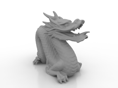

If we render the current frame, it's looking pretty good! At this point, all we need to do is change the render resolution, render, and save out a shot. First off, let's change the render resolution. You may render out whatever resolution you'd like or keep it as is. If you want to post this image on Shapeways:
Render Settings ->Common tab -> under Image Size
  • Uncheck Maintain width/height ratio
  • Set Width to 625
  • Set Height to 465
Next we want to set our Sampling Quality to high for a final render
Render Settings -> Quality tab -> under Sampling
  • Set Sampling Mode pull-down to Unified Sampling
  • Change Quality to 1.00
Position the camera as you wish. To get a better idea of how the shot will look when rendered through the "persp" camera as seen through the 3D perspective:
View -> Camera Settings -> select Resolution Gate
Once you're all ready, go ahead and render the current frame. Woooo, congrats! You've made a decent looking product shot in no time at all. To save this out:
In Render View -> File -> Save Image -> in Options... set the Save Mode: to Save Color-Managed Image
Save it outas a file of type JPEG
Done! You can now upload this and other images like it. Of course, don't forget to save the scene so you can re-use this set over and over with different models, materials, colors, etc.
