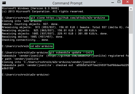

Open up a terminal, and clone the github repository that has the files to use M2X and Arduino IDE.
In the terminal, type
git clone https://github.com/attm2x/m2x-arduino
cd m2x-arduino
git submodule update --init

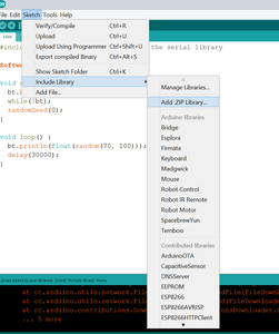

In the Arduino IDE, go to Sketch -> Include Library -> Add .ZIP library
Locate where you saved the m2x-arduino folder, and go to m2x-arduino -> vendor -> jsonlite -> amalgamated, then select the jsonlite folder that appears, and select "Open".
Now we need to import the m2xStreamClient. In the Arduino IDE, go to Sketch -> Include Library -> Add .ZIP library. Open the m2x-arduino folder, and select the M2XStreamClient folder, then click "Open".
