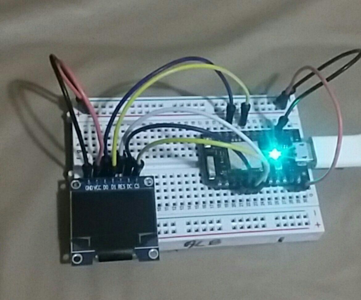

Step 1: Connections
The OLED SPI displays comes with seven pins, GND, VCC, D0, D1, RES, DC, CS. You can find the datasheet on the internet, but I think that will be not necessary for now.
Here's how you have to conect the seven pins: (On the left, display pins. On the right, board pins)
VCC -> 3.3V
GND -> GND
D0 -> A3
D1 -> A5
RES -> D5
DC -> D3
CS -> D4
Always double check if the connections are ok. Make it wrong and you may find your board dead later.
