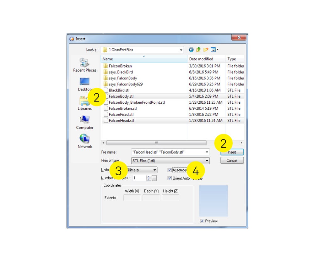

Step 2: Insert (Open) the Model
- Open Objet Studio.
- Insert (open) your .STL file with the Insert button.
- Open more than one file by Control clicking.
- Select the units.
- Check the Assembly box if needed.

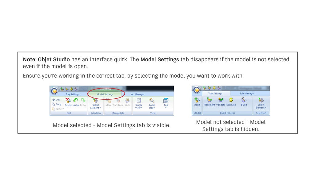

You’ll use commands under the three tabs to prepare the model and change settings.
- Tray Settings
- Model Settings
- Job Manager

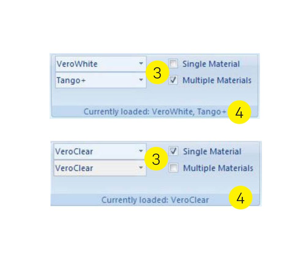

Confirm that the materials loaded in the printer are accurately listed in the software.
- Click the Tray Settings tab. This ensures that the Model tab will
display the correct materials available.
- Ensure that you are not in the Model Settings tab, which allows you to work with the two materials you selected in the Tray Settings tab.
- Confirm that the materials loaded in the printer are correctly
listed in the Currently Loaded toolbar.
- If not, select the correct materials from the menu.
- Confirm that the correct Single Material or Multiple Materials
button is checked.
- If the materials are exactly the same, check Single Material.
- If the materials are different in any way, check Multiple Materials.
- Double check that the materials list at the bottom of the Tray Settings tab matches your selection.

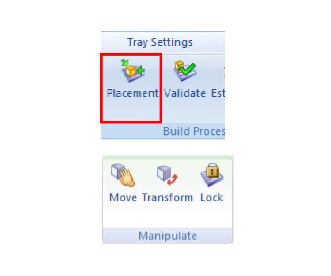

Model Placement
Objet Studio will place your part upon opening. Clicking the Placement button prompts suggestions for different placement and orientation options to create fast and lower cost printing.
- The Placement button is in the Tray Settings tab.
Model Manipulation
The Manipulate tools in the Model Settings tab are used to move, transform and lock the model.
- Move - drag the parts in the X or Y axis.
- Transform - rotate, move or scale by inputting values.
- Lock - fixes the part in place when using the Placement button.

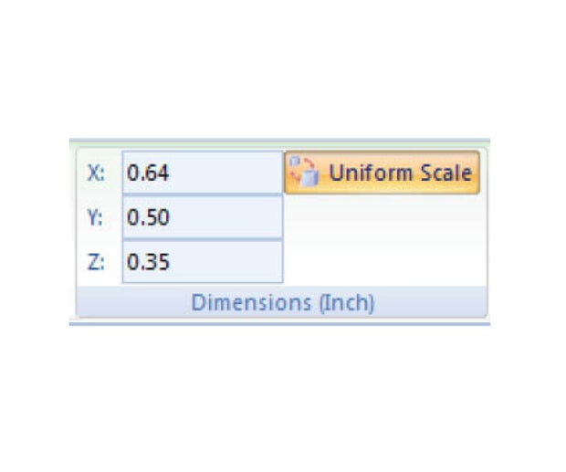

CHANGING MODEL DIMENSIONS
The dimensions tool allows you to scale the part or change X, Y or Z individually. Remember that scale is critical to time and cost of printing.
- Type a number to change the dimension of that axis.
- Deselect Uniform Scale to change an individual axis.

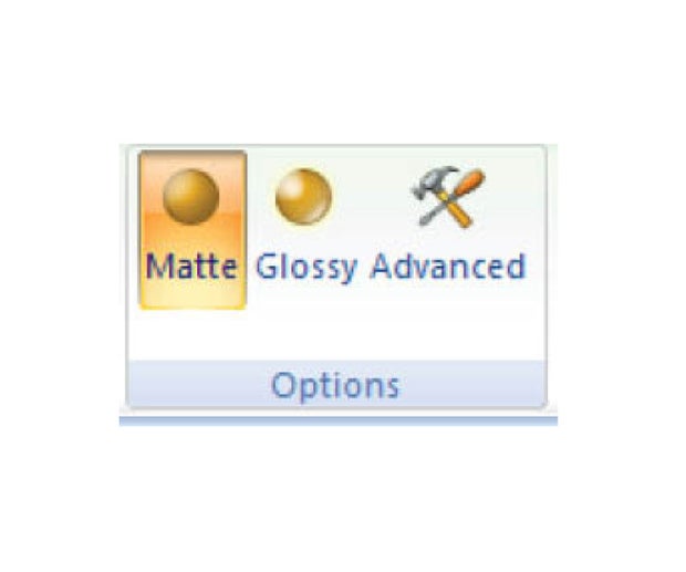

CHANGING MODEL SURFACE QUALITY
When the support material is removed, the build material under it will have a matte finish.
- Click Glossy to leave areas of the model uncoated, if they didn’t require
supports.
- Overhangs and the underside of the model will still require Support Material. There will also be a distinct boundary like the one that exists between the Glossy and the Matte areas.
- Click Matte to cover the entire part with a layer of support material,
which results in a uniform matte surface finish.
- These parts will be more dimensionally accurate than parts with a mixed surface finish.

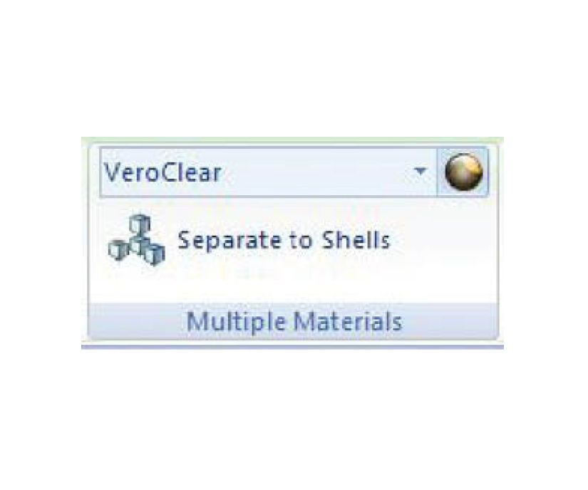

- Separate to Shells
- If you inserted (opened) an .STL file with multiple geometric bodies, this will break it into component parts.
- This option allows you to work with a single file, if it contains multiple bodies (the inverse of the Assembly option).
