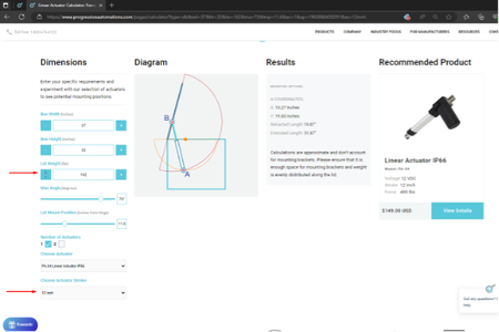

After you have measured the trapdoor, plug the necessary values into the calculator tool. By estimating the scale of your project, you can predict whether one actuator will be sufficient for the simulator or if using two actuators will be better for larger and heavier trapdoors. For just one actuator, we want to have the actuator mounted as close to the middle as we can to keep the weight as balanced as possible and reduce any chance of offset or side loading. This also helps to ensure the trapdoor can raise evenly instead of hanging or drooping due to a lack of support on the one side.
If you were to use 2 actuators, you'd have one on the left and one on the right for support and balance. When multiple actuators are required to travel synchronously, we recommend actuators with hall effect sensors. This is because they have hall effect feedback that goes to a control box which would then be able to make the needed corrections if one side travels at a different speed from the other. Differing speeds can sometimes happen from slightly unequal weight distribution or the speed tolerance from the DC motors (+/- 10%) in the actuators.
The PA-04-HS is the only standard actuator we sell with hall effect sensors from off the shelf, however, we're going to use one PA-04 actuator in this example and choose a 4-inch stroke length to start with. We'll find that the angle and the default mount position are not suitable, so we'll have to adjust those, or we'll need to choose a different actuator or stroke length.
Step 5: Making Gradual Adjustments
Calculator tool
To better visualize what variable changes have what effects, you may test out the simulator by making gradual adjustments to the variables that have flexibility. By lowering the opening angle to 24 degrees or lower, the previously chosen actuator will work, however, the result will be an uncomfortable angle to climb in and out of the basement. In this case, we will return the angle back to 75 degrees for a comfortable opening angle. By changing to longer stroke lengths via trial and error, we're able to find an 8-inch stroke that works, however, the actuator will be located very close to the wall in the X coordinate. Only having a 2-inch gap can be awkward for some installation conditions and does not leave as much room for play or adjustments if we want to take into account mounting brackets for the future.
Step 6: Adjusting for More Space
Choosing a longer stroke length allows for more options to have a larger working room that can help account for extra space to add mounting brackets in the future. Different models of mounting brackets such as our BRK-01 and BRK-02 have different space requirements due to their dimensions. You may also fabricate your own custom mounting brackets if you prefer.
Step 7: Leverage for Heavier Doors
If we find out that the weight of our door will become heavier than initially expected, this simulator can have the weight parameter adjusted. If you find the simulator with orange and red lines indicated but no actuator displayed, it could be because the chosen actuator does not have enough of a force rating for the door’s weight. In this example, the actuator disappears when there is a weight of 152 lbs because it doesn't have enough force capacity but will reappear when the weight is 151 lbs. Using a longer stroke length can allow for more leverage to handle more force. Doing so will cause the "B" mounting point to stay the same while the "A" mounting point moves backward. Using a 12-inch stoke allows for a door weight of up to 162 lbs while the 10-inch stroke could handle a maximum of 151 lbs.
