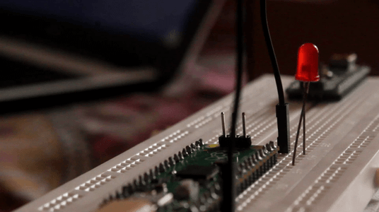

Step 1: Connect LED With Pi Pico According to the Diagram
Step 2: Connect the Pi Pico With PC and Run the Following Code.
