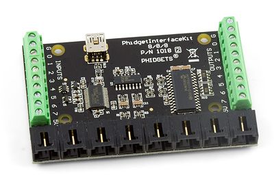

Step 2: Step 2: Attaching the Phidgetboard and Sensor
Attach a PhidgetInterfaceKit 8/8/8 via usb and connect an analog sensor to it.
I am using a potentiometer that I had left. It has different wiring from the phidget sensors so be careful.
If you have a sensor from Phidgets just connect the cable to one of the black analog ports.
That's it onto step 3
