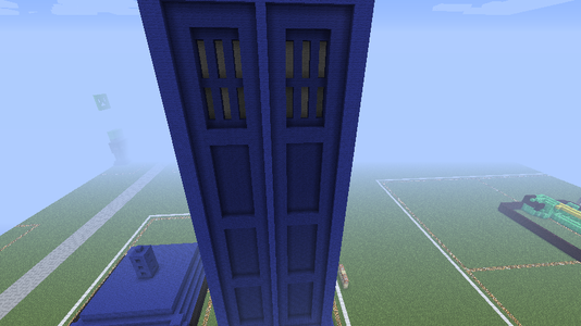

One of the nice things about Printcraft is that when it creates an STL file, it assumes that each block is 1mmx1mmx1mm. Knowing this gives us the ability to design and create an object to a specific dimension. I created custom USB sticks by taking apart drives I already owned, measuring the dimensions needed to create a case, drawing my design in Printcraft, and then printing them. The fit was not perfect, but with a little sanding I was able to make them work. I like to make the object as large as I can in Printcraft, and then use the Scale function on the 3D printer to print the size I need. In the case of the Tardis when it was drawn large enough to get the detail that was wanted, it was too tall for the available space on the Printcraft plot. The top had to be drawn separately and then pieced together. The plot dimensions have changed since that object was drawn and I am not sure what the largest item is that can be drawn today.
