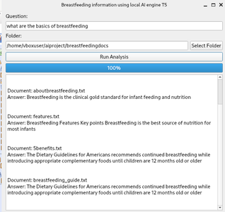

Python program that uses the T5-Small AI engine to take a question from a user, scan text files in a folder on the local computer, run them through T5-Small AI engine and extract information from each text document. For some reason, Instructables would not allow the Python file to be uploaded, so it has been uploaded in PDF and ODT formats, which can be copied and pasted into a Python IDE. The code is also in step one, so it can be copied and pasted from there.
Be sure to create several text files to be placed in a folder on the local computer for the T5-Small AI engine to scan. In the screenshot example above, I used a few text files on breastfeeding.

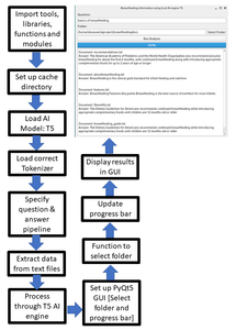

Also created 2 flowcharts to help understand how the program works: one from Mermaid code and one from Powerpoint.

Flowchart of program:
> Import tools, libraries, fucntions and modules from Python
> Set up cache directory
> Load AI model: T5
> Load the correct tokenizer
> Specify question and answer pipeline
> Start function to extract data from files in a separate thread
> For each text document in folder:
> Extract information from text
> Process through T5 AI engine
> Set up PyQt5 GUI
> Function to select folder
> Update progress bar
> Display results in GUI
