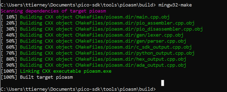

Step 4: Making and Testing Pioasm
If the previous step worked we can now finally build pioasm.exe. In the same build folder run the following command (see photo above).
mingw32-make
When that step completes type the following command in the build folder to see if pioasm works
pioasm

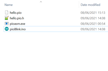

The first step is to write some PIO code. I'm not going to do/explain this. Just download/copy the pio example code here. Once you have this file put the pioasm.exe file in the folder as well. The run the following command at the command prompt from within that folder
pioasm.exe hello.pio hello.pio.h
This creates the file hello.pio.h which you can include in your Arduino sketch to call PIO functions.
Now write the following into an Arduino sketch. Note this is a little different from the Raspberry pi example as it uses the familiar setup() loop() structure. Once you have written and saved the sketch your folder structure should like the one pictured above.
#include <hardware/pio.h>// Our assembled program:#include "hello.pio.h"PIO pio = pio0;uint offset;uint sm;void setup() {offset = pio_add_program(pio, &hello_program);sm = pio_claim_unused_sm(pio, true);hello_program_init(pio, sm, offset, PICO_DEFAULT_LED_PIN);}void loop() {// put your main code here, to run repeatedly:pio_sm_put_blocking(pio, sm, 1);sleep_ms(5000);pio_sm_put_blocking(pio, sm, 0);sleep_ms(5000);}
