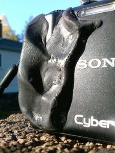

Step 6: The FIX: the In-camera Flash Position
Next up - the Flash Fix.
I did a similar thing to the last step on the front of the camera body.
Using black Sugru I created a form fitted mold for my bottom three fingers in their proper placement positions on the camera's face while my index finger rests on top of the shutter button (ready to take pictures).
I then let the Sugru dry for the recommended 24 hours to completely harden.

On the issue on the front side of the camera my fingers are now 'walled-off' from getting anywhere near the flash without feeling that distinct, uncomfortable 'ridge' underneath.
That means that those half-dark, half-lit flash photos I used to take are now a mere annoying memory in the past.
