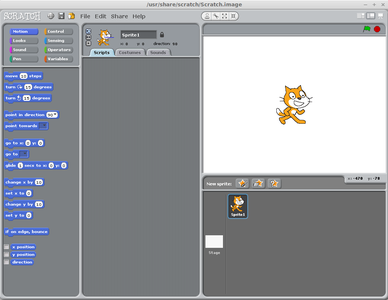

Step 4: Download and Install Scratch
Head over to http://scratch.mit.edu/ and get the latest copy of scratch.
Once you have it, open it and look around.
- You have your commands on the left bar,
- The middle is where you will drag the commands to, in order to create your code
- The right side shows your sprite (the default is a cat), which is the character you will use to move as your first attempt.

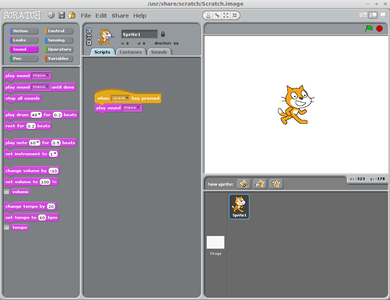

To start, Click on the "Control" icon, grab the icon that says "when Space key pressed" and drag it to the middle window. You'll notice that Space is a dropdown. That's where you can change what key you want to be pressed, to then do a function. Let's leave it with Space and instead look back to the left bar. Click on "Sound", then click and drag the icon for "play sound Meow". Again, there is a dropdown where meow is. When you move on to do more complicated things, you can add sounds by recording or downloading them, then choose them here.
There you go, now go ahead and press the coin on your new controller that is attached to the "Space" section on the Makey Makey board. Did it make a sound on the PC? If not, check your connections, check your speaker, etc. When you do end up getting it to Meow, stop and congratulate yourself! You just made your controller control the character on your screen and made it Meow. Now go ahead and add a few more Controls to the screen. Do one for Up, Down, Left, Right. Feel free to follow the screen shot.
