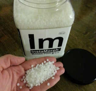

Huge credits tosmalltortoise for exploring protection of an arduino board with Instamorph in their instructable - https://www.instructables.com/id/Protect-Your-Ardui...
However, personally, I'm not convinced by this idea because removing instamorph for any reasons from the components might cause them to break parts off accidentally. It's too hard to have flexibility for a wearable.
