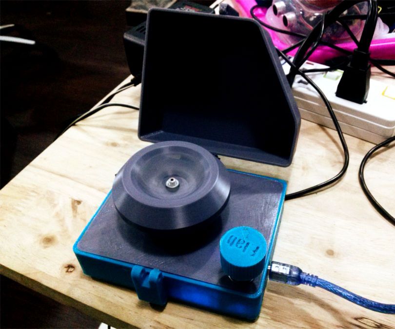

For our 2-3 hour-long workshops, we usually have students design something simple like a keychain. But we have used SketchUp to design 3D printed items such as laboratory equipment, automatic fish feeders, and custom project cases for IoT systems and voltage regulators for solar powered projects.
