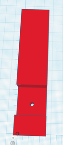

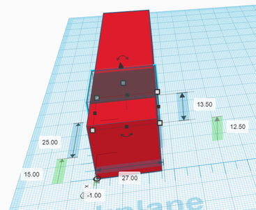

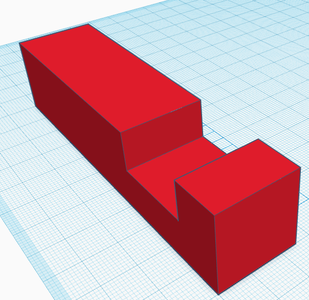

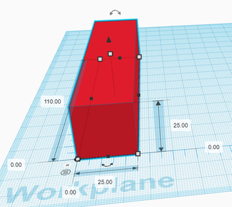

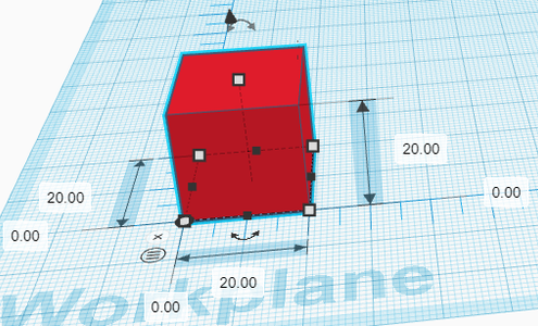

To draft the fence, I created a 25mm high x 25mm wide x 110mm long box in Tinkercad. Click the ruler button and drag a ruler to the front bottom left corner of the piece. It makes the next steps much easier.
Now, create a box 'hole' that is 13.5mm high x 27mm wide x 25mm long. Position it by typing in the values (-1, 12.5, 15) as shown in the image.

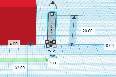

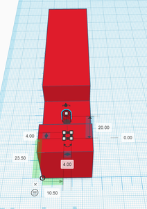

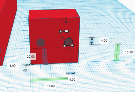

Group the two boxes. Now draft a cylinder 'hole' that is 4mm x 4mm x 20mm high. Position it by typing the values (10.5, 23.5) as shown in the image. This is the hole for the adjustment screw to tighten into. We've made it a bit undersized so that it can be drilled to fit whatever hardware you're using.
Group the cylinder with the fence to finish this part.

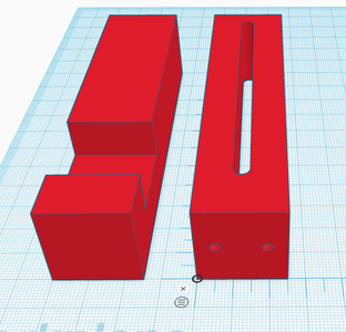

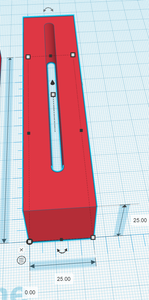

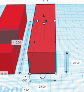

Create a box 25x25x110mm to be the adjustment bar. Move the ruler to the bottom left corner of the box.

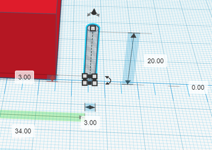

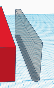

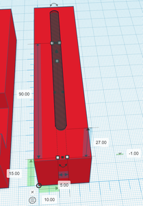

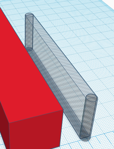

We need a slot cut through the bar to allow adjustment. Create a box 'hole' that is 5mm wide, 27mm high and 85mm long. To tidy the ends up, create two cylinder 'holes' that are 5mm x 5mm x 27 mm high. Drag them onto the ends of the box 'hole'. I needed to type in half millimetre values to get things lined up perfectly. Group the two cylinders with the box hole.
Drag the hole so that it is centred horizontally on the adjustment bar block, 15mm back from the front edge. Group it with the bar.

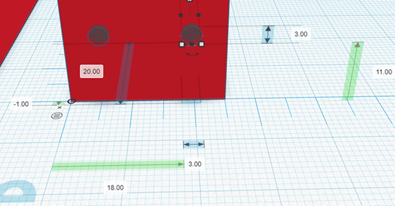

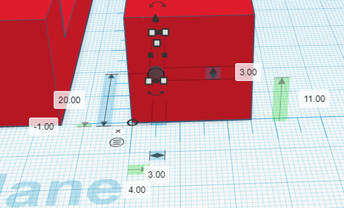

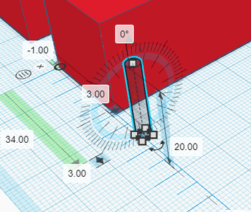

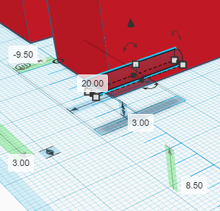

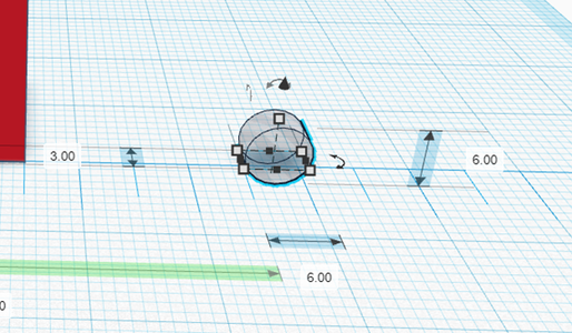

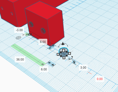

Now, create a cylinder 'hole' for the blade mounting screws, 3mm x 3mm x 20mm long. Rotate it 90 degrees as shown, then position it 11mm up and 4mm from the left edge of the shape. Copy it (ctrl-c) and paste it (ctrl-v), then position the copy 11mm up and 18mm from the left edge of the shape. Group both holes with the adjustment bar, which is now complete.

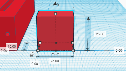

Start with a block that is 25x25x15mm. Move the ruler to the bottom left corner.

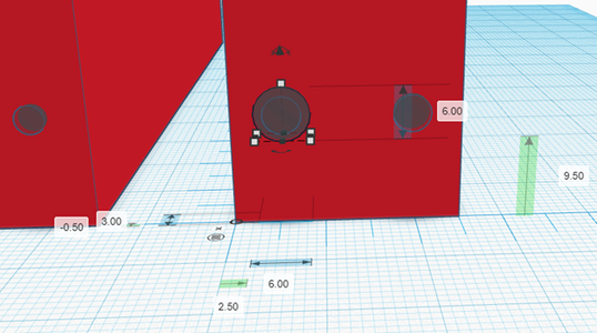

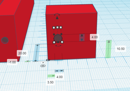

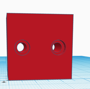

Create two 4mm cylinder holes for the screws to pass through. They should be positioned 10.5mm high. One should be 3.5mm from the left edge and the other should be 17.5mm from the left edge. Bonus marks if you can figure out how to place the second hole by measuring 3.5mm from the right edge :).

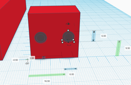

To give a more finished look, create counterbore holes for the screw heads. Mine are 6mm in diameter, so they are both 9.5mm high and are 2.5mm and 16.5mm from the left edge.

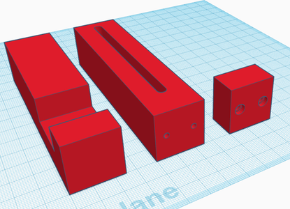

Export your file as an STL or OBJ and use it to print your file. I used 30% infill on my FDM printer. Using supports is optional, depending on how well your printer bridges the top of round holes.
If you want to skip the drafting, use the attached file to print the clamp or send it to an online printing service.

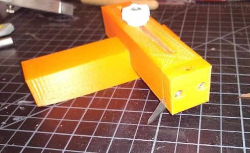

Now, take two M3x25mm screws. Feed them through the blade clamp and into the holes in the end of the adjustment bar. Tighten them most of the way, then put the blade of your choice, either a scalpel blade or a 9mm blade into the clamp. It should be at a fairly low (flat) angle to cut smoothly. Make sure that the tang of the blade doesn't stick out of the clamp or you will have a rough cut!
Step 6: Now Cut Some Strips...
Set the width of the strip you want to cut. Run the blade along the top of the foam, then flip the foam and cut it again. You'll get nice, clean, repeatable strips.
Using 9mm or even 18mm blades should allow you to cut up to 3/4" in a single pass, meaning it's quite reasonable to cut even 1" foam into strips.
