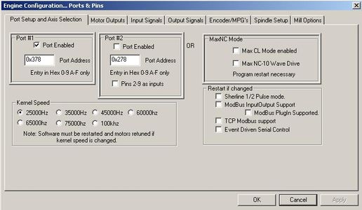

- Open up your typical Mach3 Profile, or make a copy of the profile and rename something like Zen_Laser, so you have a separate laser engraving profile.
- Go to the Config tab --> Ports and Pins
- Once the new window opens, choose the "output signals" tab.
- Change "Output #1" to enabled, with Port #1, and Pin #17. (Shown in picture)

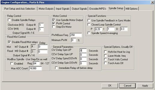

- Now navigate to the "Spindle Setup" Tab. Change all options to be the same as those shown in the photo.
Your Mach3 software is now ready to control the laser on/off !
