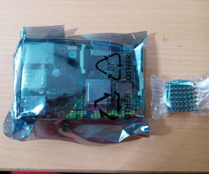

Step 1: What You Need
An Ergometer or Elliptical Trainer works good. If you have a rowing device with flywheel, then it should work, too.
2x ANT+ Stick *I use Garmin and a noName Ebay Link
1x Raspberry PI 2 or 3 All in package
Some 4.7K Resistors Resistors
Some 50K Resistors Resistors
1x Magnet (I use a cube neodym)
1x reed Switch (fast) KSK 1A87
1x connector/ terminal strip (4 ports are good) Terminal Strip
Some Wires / Dupont connectors Cableset
A piece of PCB *optional PCB
A PC or Laptop / MAC for Zwift Software To Zwift
