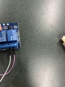

  5. Relay module (A 4 Channel Relay is what I used)

Step 2: Connect the Arduino's Power With the Relay
For this step you will need to use the Breadboard, arduino, and relay module. As well as some wires to connect everything.
So start off with connecting the 5v pin on the Arduino to the positive line on the breadboard. Once that is done connect the positive line of pins on the breadboard to the VCC pin on the Relay Module as well as connect a line from the positive pins into the common port (middle port) on the relay switch you are using.
Step 3: Controlling the Pump
Now that we have connected the power we need to control the pump so we need to connect the negative wire from the pump into one of the ground pins on the arduino. Once that is done connect the positive wire from the pump to the open -circuit port (left port). Next, Connect digital pin number 7 with the relay pin IN1. Now finally connect the fish tubing onto the water pump.
