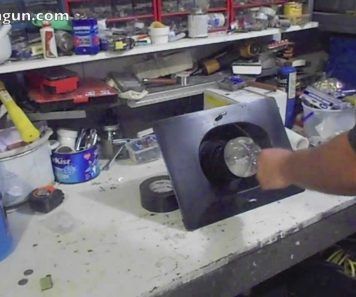

The channel was too expensive and the aluminum block that I remember seeing in the electrical aisle at Lowes was no where to be found, so I bought three large nuts and cut a channel in them by placing them in a vice and hitting them with an metal cutting circular saw (you can’t use a skill saw with a metal cutting blade the RPM and torque is different.
This slot allowed me to place the nuts over the lip of my kettle grill so as to make a air gap between the top of my grill and the bottom of the disco grill. This allowed the smoke to flow and heat to rise out more efficiently.
You can see in the picture how I set the nuts on to the grill so to allow the grill to sit perfectly balanced. The last thing you want is to have the grill unbalanced, tip, and cause the dog to get all your nicely grilled but slightly dirty meat.
