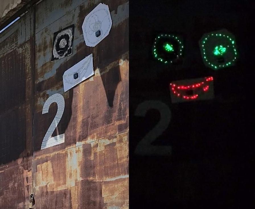

I use them to hang pictures and solar-powered LED lights on top of abandoned towers and fences.
You might ask why, but that is the wrong question. The right question is how?

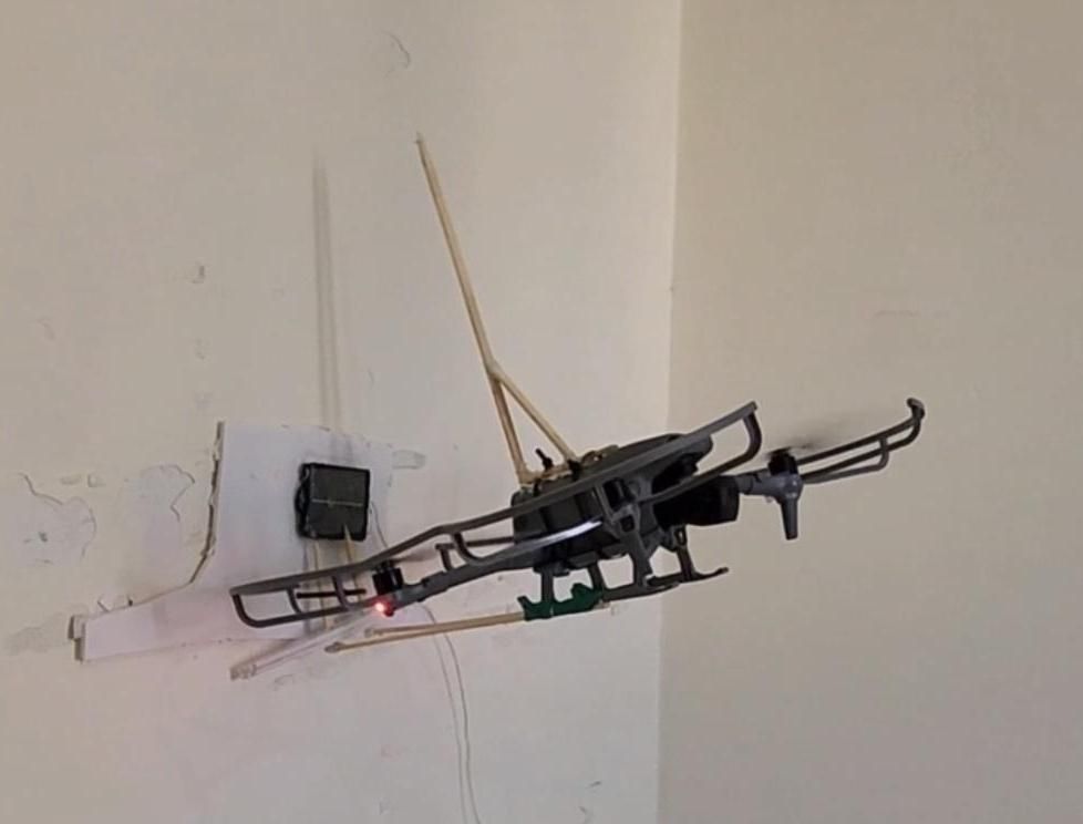

Step 2: Attaching Payload to the Drone
The naïve approach is to hang the payload from the drone with a wire directly below the drone. However, this will cause the payload to rotate and swing randomly making it hard to position. Also if the wire goes directly below the drone it can block the drone's downfacing sensors making it behave strangely.
The solution is to attach a horizontal stick to the drone so that the payload can be hung using wires from both sides of the stick. This gives a broad base and two attachment points which make the payload more stable. The stick can be attached to the payload release mechanism using a zip tie. The important part here is that if the stick is too loose it can move and vibrate and even touch the propellers, so you want the zip tie to be very tight. However, if the stick is too tightly bound to the payload release system it can create friction that will not allow it to be released. So there is a narrow balance here. I found that padding the stick with soft padding tape allows it to squeeze into the payload release device without creating too much friction. It's also recommended to check that the stick is stably bound to the release mechanism even under vibration but can also easily be released before actually flying.
For this I used 40 cm skewer stick. Binding the payload to the stick using thin metal wires (0.2-0.5mm). The reason for preferring metal wire is to reduce vibrations and swinging. Wire length of around 1.8-2 meters distance between the drone and payload is good for AIR 3.

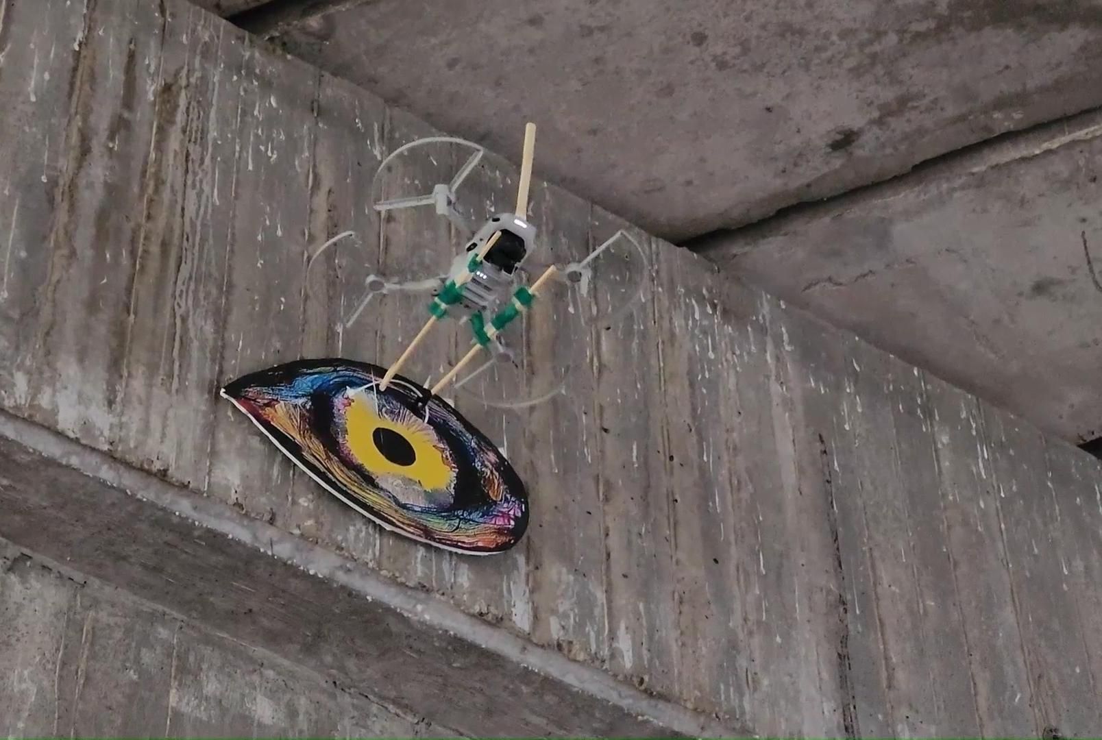

Step 3: Hook and Hanging
It might sound simple to just fly with the hook above the fence and descend until the hook grabs the fence. This however is very hard given the limited precision of the drone and the payload's tendency to swing.
A much easier approach is to make one side of the hook shorter. Then move the drone with payload forward until the payload presses into the target, once the drone reaches and slightly passes the target the payload below the drone will be pressing the target (target means fence/beam/cable). At this stage, it's easy to position the hook by moving the drone up and down.
