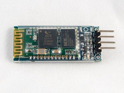

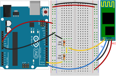

The HC-06 has 6 pins: wakeup, VCC, GND, TXD, RXD and State, but for this you will only need to use 4 pins, VCC, GND, TXD and RXD. Here is how you should connect the Bluetooth module to your Arduino.
HC-06>>>Arduino
VCC>>>>5v
GND>>>>GND
TXD>>>> Pin 0 (RX)
Please note: While the HC-06 will tolerate 5V power, the RXD pin can only handle 3.3V. As the Arduino pins use 5V logic, wiring directly from the Arduino's output pins to the HC-06 may damage the Bluetooth controller.
In order to keep the voltage at safe levels, use a potential divider to connect the RDX pin to the Arduino's TX pin (Digital Pin 1).
RXD>>Potential divider>>TX
The HC-06 acts as a serial port through which you can send and receive data. By using a serial terminal or a Bluetooth customized application on your computer or phone, you can control and monitor your project. Before uploading any code to the Arduino, disconnect the HC-06 module, since it shares the tx/rx pins and will interfere with the upload. Connect it again once the code has been uploaded successfully.
