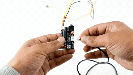

Step 2: Connecting Electrode Cable
Connect the BioAmp Cable to BioAmp v1.5 as shown in the connection diagram.
Note: Don't place the electrodes on the skin at this moment.

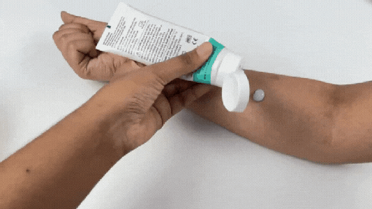

Step 3: Skin Preparation
Apply Nuprep Skin Preparation Gel on the skin surface where electrodes would be placed to remove dead skin cells and clean the skin from dirt. After rubbing the skin surface thoroughly, clean it with a wet wipe.
About Nuprep Gel:
Nuprep skin preparation gel is a mildly abrasive, highly conductive gel that should be applied before placing the electrodes on the skin to improve measurements. When applied gently, it strips away the top layer of skin and moistens the underlying skin layer which reduces the skin impedance with minimal skin irritation and discomfort.

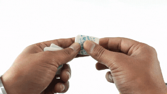

  1. Connect the BioAmp Cable to gel electrodes,
  2. Peel the plastic backing from electrodes
  3. Place the IN+ and IN- cables on the arm near the ulnar nerve & REF (reference) at the back of your hand.

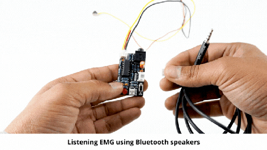

Listening EMG on a speaker using BioAmp AUX Cable:
  1. Plug the BioAmp AUX cable on BioAmp v1.5
  2. Connect the BioAmp AUX cable on the speaker
  3. Switch on the speaker and turn the volume to maximum
  4. Flex and listen to your muscles.
