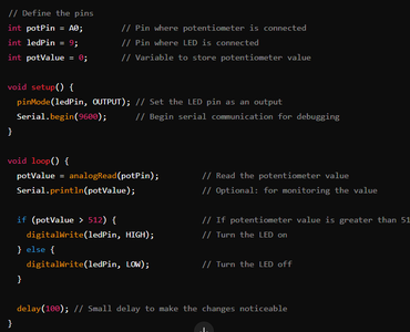

Step 2: Code
the image above shows the code
Step 3: How It Works
How It Works:
  1. Reading the potentiometer: The potentiometer is connected to analog pin A0, which reads values between 0 and 1023. When you turn the potentiometer knob, the Arduino reads these changes.
  2. Controlling the LED: In the code, if the potentiometer value goes above 512 (halfway), the green LED turns on. If it’s below, the LED stays off.
  3. Serial Monitor (Optional): You can open the Serial Monitor (in the Arduino IDE) to see the values from the potentiometer in real-time. This helps you see what’s happening as you turn the knob.
