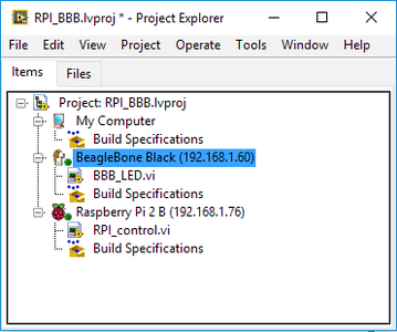

Download the LabVIEW project attached below. Before you open the individual VI's you will need to change the IP address shown to the specific IP addresses of your BeagleBone Black and the Raspberry Pi. To do this right click on the Beaglebone Black and select "properties".
screen-shot-2016-09-14-at-10-39-34-pm
Change the IP address in the input that says "IP address/DNS name". Repeat this process with the Raspberry Pi. Once the IP address is correct right click each and select connect, this will open a connection to each device.

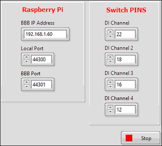

Start by opening the RPI control VI under the Raspberry Pi category. Before you can deploy you will need to change some things on the front panel. Start by changing the DI channels to the DIO pins you attached to the switches. Next, input the IP address of your BeagleBone Black. Finally, you will choose the Local port and the port you will be sending to, I would keep these the same unless you have reason to change them.
rpi__controld
Above is the block diagram for this VI, the first block is a LINX open. It is set to Local I/O because we are using a Raspberry Pi the code that you write in LabVIEW actually gets deployed to the board. After LINX is opened open a UDP socket and then enter the while loop. 4 digital reads inside the loop get data from each switch then it is it is all bundled and UDP write sends it to the BeagleBone Black over Wi-Fi. Once the stop button is pressed we leave the loop and close the LINX reference as well as the UPD socket.

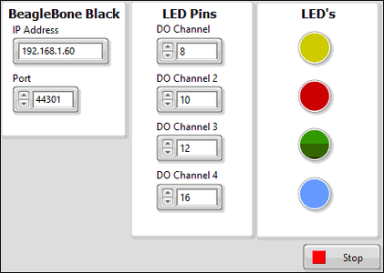

Next, open the BBB_LED VI under the BeagleBone Black category. Again, before you can deploy you will need to change some things on the front panel. Start by changing the DO channels to the DIO pins you attached to the LED's. Next, input the IP address of your BeagleBone Black. Finally, you will choose the port, make sure this matches the port you set in the RPI control VI.
bbb__ledd
Above is the block diagram for this VI, you can see that again we start with a LINX open set to local I/O because we are deploying this code to the BeagleBone Black. Next, we enter the While loop and open up a UDP socket, it then splits into two different while loops. The top while loop uses a UDP read to collect the data sent over from the controller, the bottom loop uses that information to determine whether or not each specific LED should be lit. To end this code, we press the stop button which will exit both the inner loops, then when it's out of the outer while loop we close LINX as well as the UDP socket.
