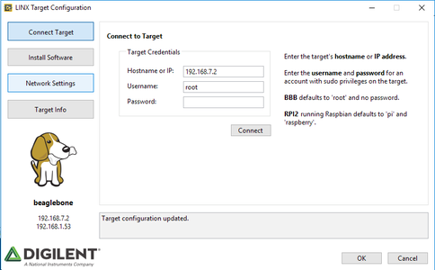

- Launch LabVIEW and open the Target Configuration Wizard from Tools»MakerHub»LINX»Target Configuration.
- Enter the BBB Hostname or IP and a username and password with root privileges and click connect.
- Default IP Address for the BBB USB/Ethernet device is '192.168.7.2'.
- Default Username is 'root'
- Default Password is empty.
- Click the Install Software tab.
- Click Install.
- Review any warnings and complete the installation.
In the bottom left corner, you can see the USB and Ethernet IP addresses under the BeagleBone Black logo. You can see from the picture above that my ethernet IP address is 192.168.1.53, you will need to use this IP address later so write it down.

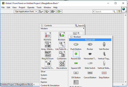

Step 5: Setting Up Global Variables
- Click shift and double click on one of global variables to bring up its front panel.
- From here add a boolean LED and a numeric indicator.
- Change the names to something short and descriptive, I chose "LED" and "Temp".
- Save the file, make sure you know where it is because you will need to open it in a later step.

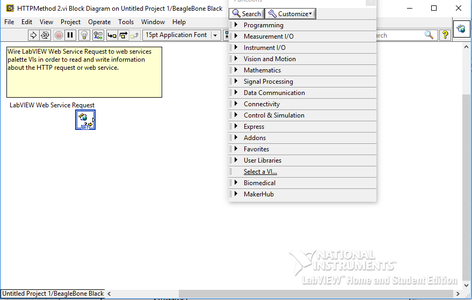

Step 8: Thermistor Web Service Part 1
- Again, right click on Web Resources and then select New VI.
- Press Ctrl+E to switch to the Block diagram and then right click to open up the functions palette, select "Select a VI".
- Select the Global VI you made in step 5.
- Click on the LED function and a drop down menu will appear, select Temp.
- Right click on the Temp function and select "Change to Read".
- Right click the LED VI and select Create»Indicator

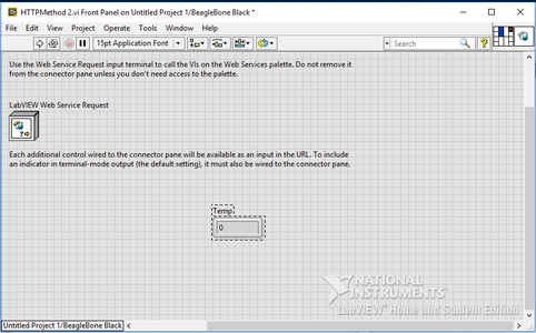

Step 9: Thermistor Web Service Part 2
- Switch back to the front panel, you will see a box like the one in the picture above in the top right corner, select the top right box.
- Next, click on the Temp, the box you selected in the last step should turn orange.
- You select this box because the Temp is an indicator.
- Save the file, give it a short descriptive name, I chose Temp.
- From the project menu, right click on "ws" and select start, after it is done compiling you will be given a port number(often it will be 8001), write this down it will be needed to connect it to the tablet.

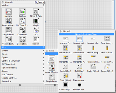

- Select the plus sign next to the poll and then select Create new indicator
- Select the gauge from the indicators palette.

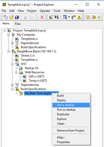

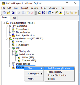

Step 11: Setting Up a Start Up VI
- From the project menu, right-click the build specification and choose New>>Real-Time Application
- Save the project, I chose to name mine "Tempblink".
- Go to the "Source Files" category and select all of the project files and click the arrow to move them into the Startup VIs
- Go to the "Web Services" category and click the box next to your Web Service name. You will see an HTTP port, write down this number, you will now use this port number to access the web service from your tablet.(previously I used 8001, now I would use 8002)
Step 12: Run the VI As a Startup
- Right click the new build specification and choose Build and then click Done. Next right click the new build specification and choose Run as Startup. Click Yes to reboot the target.The VI will now run whenever the target is powered on.
