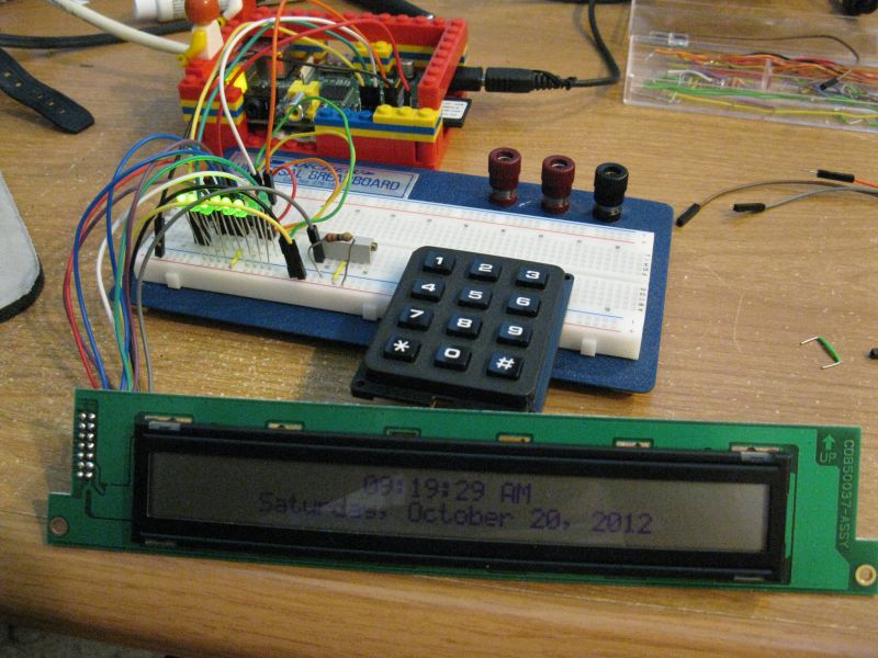

Step 3: Prepping for Prototyping
Now that I knew what it did, I had to make it do it. I desoldered the ribbon cable and installed header pins I scavenged off an old video card. I marked the back of the keypad with the key/pin combinations.
Next I wired it up to the Raspberry Pi. The actual pins you use don't really matter, as you'll include them in the code, which I've attached to this step.
My code includes a list for the rows:
rows=[26,24,23,22,11]
A list for the columns:
cols=[18,16,15,13,7]
And a multidimensional list for the key/button combinations
digits=[["1","2","3"],
["4","5","6"],
["","","9"],
["7","8","0"],

Step 4: Next Steps and Issues
There were two main issues with this project.
The buttons tended to "bounce"--show more than one press per press. To eliminate this, I put in a sleep statement of 1/100 of a second in to the code as the button was pressed and another when the button was released. This made the "bounce" go away.
Additionally, the CPU ran at 100% while polling the rows and columns. I put in a pause of 1/10 a second at the start of the polling loop, and this dropped the CPU usage to about 50%. Better, but not great.
