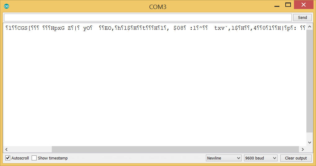

Open up the serial monitor in the Arduino IDE and press a button which switched on the socket on your remote that came with your remote socket, and you should see something like this:
Received 1394007 / 24bit Protocol: 1
These are the only real import parts that you need to keep an eye out for, and you'll need to put these into the sending script to send the same data to the remote socket to switch on.
Then do the same for the off button on the remote, again make a note of the code.

Hi, I did the exact circuit as described but all I get in serial monitor is random symbols when I press nodemcu reset button. Would you mind showing me where the mistake is pls?
