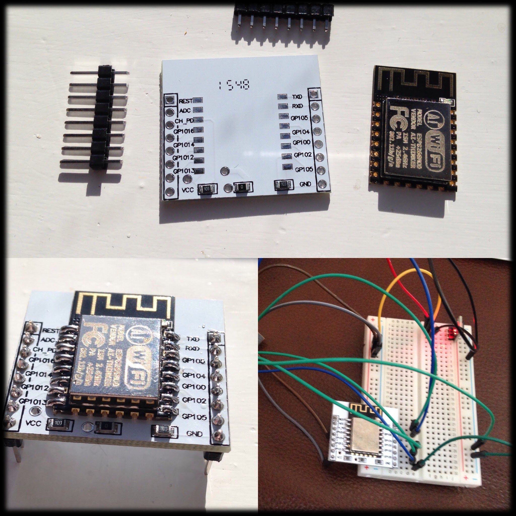

This Instructable shows how to connect a relay module to an esp8266, something that should be straight forward but needs a few extra components to make the relay work correctly if you're using the small esp device in the pictures.
This board was from ebay and has an AMS1117 voltage regulator built onto the board so that you can connect it straight to a USB type power source.
The board also comes with a little daughter board which has a CH340G chip on it which allows you to plug the esp board into it and program it, and once programmed the esp can then be removed and used in a project.
There are upsides and downsides to this form factor which are that once the esp is programmed if you need to change some of your code you need to take it out of your project and plug it back into the programmer. An upside would be that the esp device is smaller than a NodeMCU Devkit, so if you're tight for space this might be a good trade off.
The circuit on the veroboard in these pictures is doing more than just the relay control. More on that in another Instructable later.
