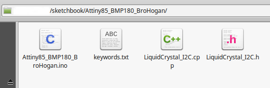

In this link you will find the configuration that works for me on IDE 1.6.9. Put all those files (except the picture) in ONE directory, where also your INO file goes

Avoiding problems
Most problems you may encounter are related to the IDE getting confused regarding the libraries. If you are using the standard Arduino LCD library, best replace it by the Bro Hogan library. If you are using Malpartida's library and want to keep that (as it is a great library), move it out of the way. Grab the entire folder and move it out of your sketchbook/libraries folder. Make sure you have the TinyWireM library installed and make sure your libraries are up to date.
If for whatever reason you cannot or do not want to move the Malpartida library out of the way, either rename the LiquidCrystal_I2C.h and LiquidCrystal_I2C.cpp modules in that library, or put the BroHogan LiquidCrystal_I2C.h and LiquidCrystal_I2C.cpp files in your sketch directory (and change the fishhook call into parenthesis).

Step 1: I2C LCD on Attiny 85: the Program
I am always a bit hesitant to put a program including libraries on instructables as sometimes the so called 'fishhooks' around the library are interpreted as html code and make the name of the library disappear, even after I made sure they were there.
Nevertheless, you will find the code below, but just make sure to compare it to the screenshot in the IDE that I have attached in this step
#include <TinyWireM.h> #include <LiquidCrystal_I2C.h> LiquidCrystal_I2C lcd(0x20,16,2); // set address & 16 chars / 2 lines void setup() { TinyWireM.begin(); // initialize I2C lib lcd.init(); // initialize the lcd lcd.backlight(); lcd.clear(); // Print a message to the LCD. } void loop() { lcd.setCursor(0, 0); lcd.print("Hello World on Attiny85"); }
Step 2: Using an I2C LCD on Attiny85: Still Problems
Hey, I did everything you said, but it doesn't work
I realize that is frustrating, but I can give you the assurance that the program and the libraries will work as they have for me.
When I first did this.... months ago, it worked immediately, without any problems. But when I tried this again for the sake of helping someone out (and this instructable) I got error message after error message on compilation.
However, that was on a computer that was pretty loaded with sketches and libraries and processor cores. Fortunately I also had a system that I just freshly put a new Linux on with just the basic 1.6.9 IDE installed, without further libraries added. I put the 85 core on it, put the Bro Hogan I2C code in the library and it immediately compiled without problems. So if you have compilation problems, it is probably because you do not have the proper libraries installed or the IDE gets confused about the libraries.
What compilation errors do you get?
-I just get a compilation error status 1
That means that for whatever reason your IDE couldnt link and compile all the required modules
-It tells me there is no 'int' for my 't_backlight'
It is pulling in the wrong library, most likely the Malpartida library.
-I get a bunch of USI errors
Your TinyWireM library might be corrupt or wrongly installed
-I have the right I2C library, but I suddenly see a LiquidCrystal_I2C.o file that wasnt there before + some other files.
Most likely you inadvertedly let your library manager do an update and your library got replaced
If you get errors 99% of these have to do with the wrong libraries. Make sure that in your preferences you set 'verbose reporting' and check what libraries are being linked. Are these the correct ones?
Also, whenever you change something in your libraries, close and restart your IDE, otherwise it will just keep using the old versions.
