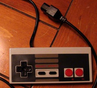

Only five of the seven pins on the NES controller connector are used, one is ground and one is +5V, leaving three interesting ones.
This explains the pinout and timing:
http://www.mit.edu/~tarvizo/nes-controller.html
You can wire directly to the holes in the controller connector but I used the mated part that is connected to the board inside the NES case to get a more secure connection (See Picture).
I have the "pulse", "latch", and "data" pins going to pins 6, 7, and 8 on the arduino, but you can change it in the code to whatever pins you want.
