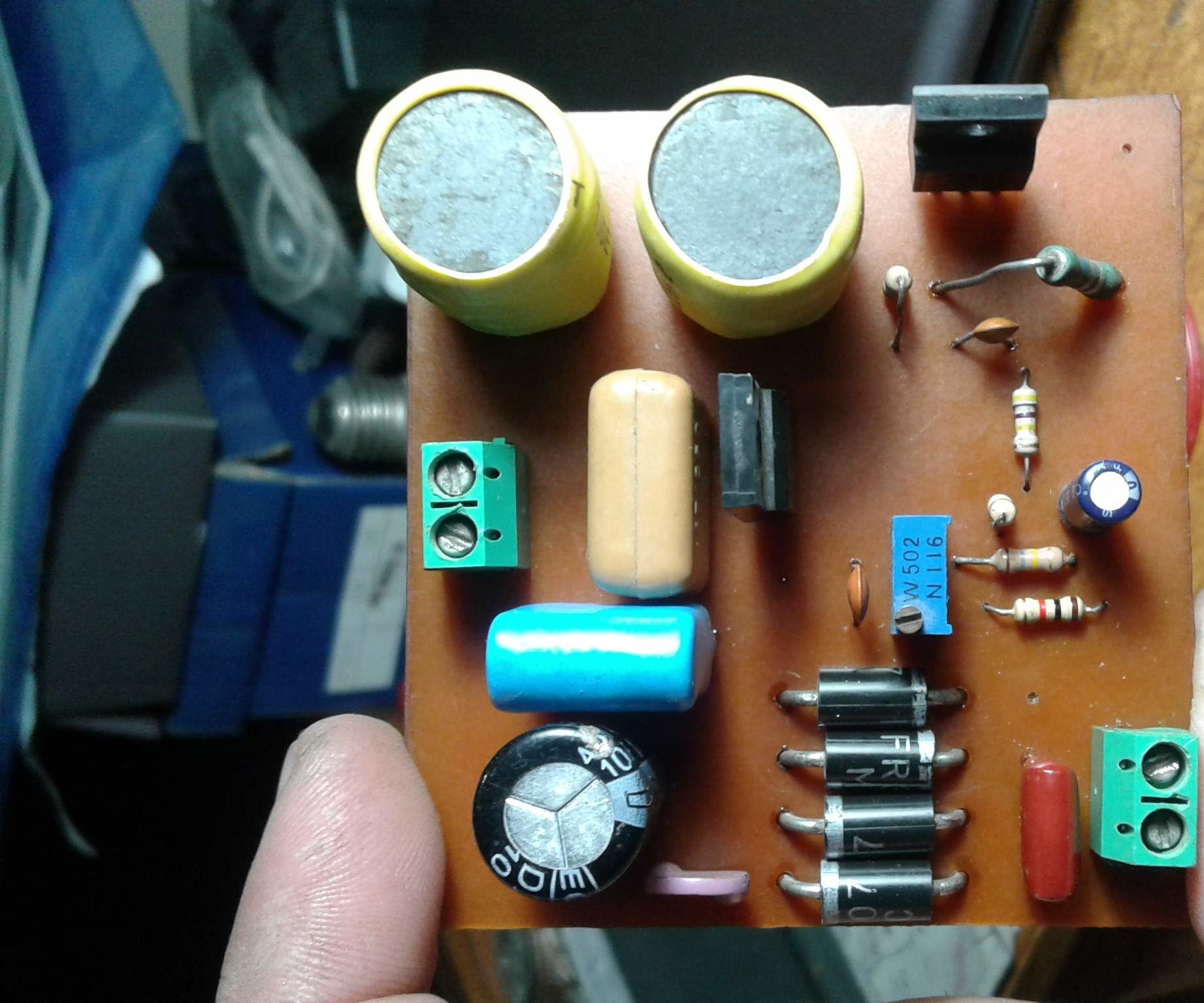

Step 4: Bridge Rectifier
Make bridge rectifier and add capacitor on the output
You need a ultra fast switching diode uf4007 or similar and 0.1uf 400v capacitor
Step 5: Add BR on the Circuit Board
Now solder the bridge rectifier to the circuit board from where you have removed the filament joining capacitor
Step 6: Connection Wires
Now add connection wires to the output of the BR +ve and -ve
Here you will get about 100V DC and 130 mA current
