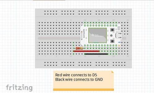

Step 1: Circuitry
The circuit utilizes the fact that current follows the path of least resistance. Hence current will always flow through the breakable connection and only once the connection is broken current flows to the selected pin which will trigger the notification.
The black wire in the schematic is replaced by the white wires in practice. These are connected to plates constructed of aluminum foil and cardboard. One of these plates is attached to the door and the other to the door frame. Hence once the plates do not touch when the door is opened the current flows to pin D5 and a notification is triggered.
