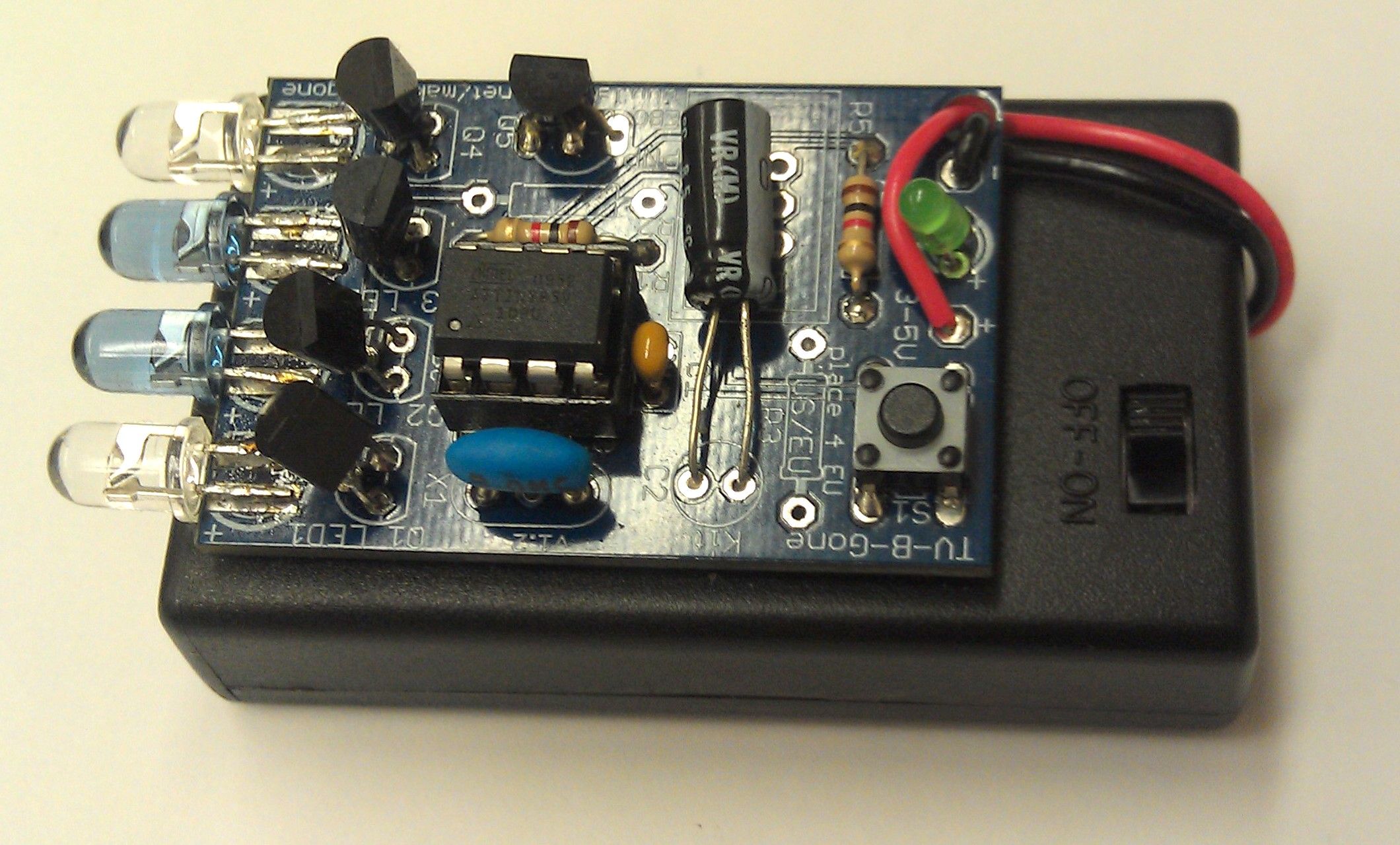

For example, I have a hack for the TV-B-Gone that turns it into a Super Camera Remote. The TV-B-Gone uses an external 3 pin ceramic resonator like the one pictured here. If you take the processor that comes with the TV-B-Gone, or program the fuses using the makefile in the open source firmware package, you'll get this error:
Fortunately, Randofo includes female headers as a breakout of all the pins. Get one of these 3 pin resonators and connect the middle pin to Ground (pin 4) and the other two to pins 2 and 3.avrdude: Device signature = 0xfff000
avrdude: Expected signature for ATtiny85 is 1E 93 0B
Double check chip, or use -F to override this check.
If you do this, you can reprogram, including going back to internal clock!
Here, I used a breadboard, but it would also be easy to take a little strip of protoboard and make a little header to plug right in.
