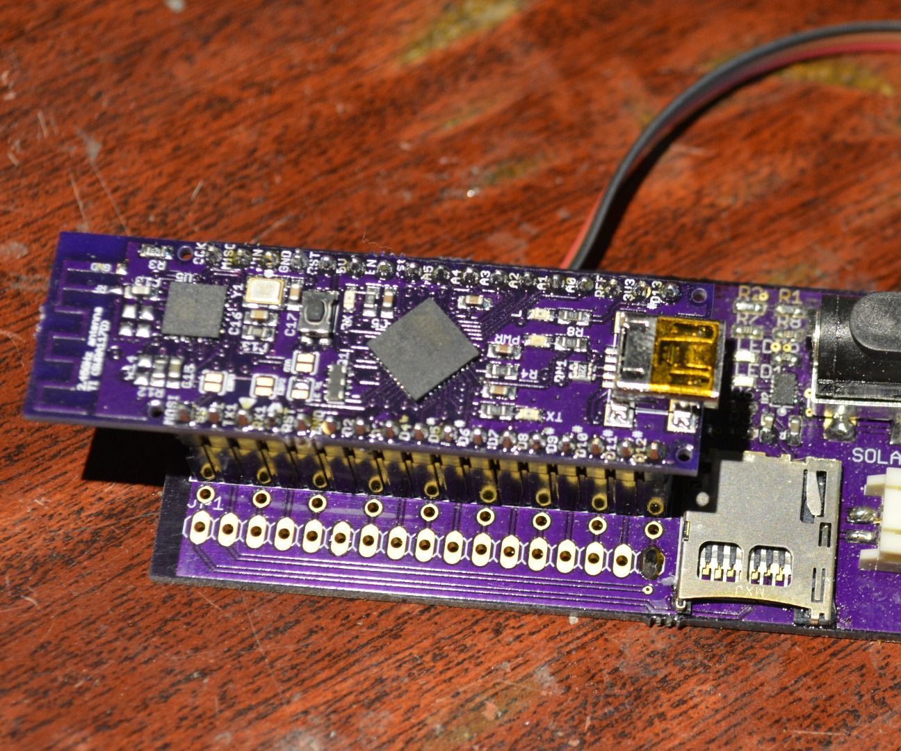

For this testing, I installed the Arachnio into an ArachnoProto to protect the pins and remove confounding factors.
